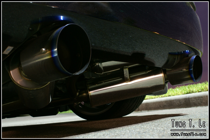

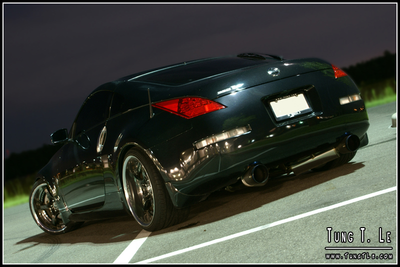

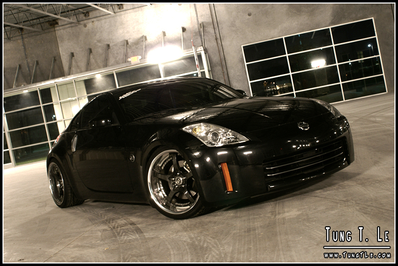

ok here it is 06 REV-UP base HKS exhaust Injen intake... Next should be the MREV2 and the 5/16 spacer correct??? Then the UTEC?? not too sure

she needs opinions about next engine mods

i like my pulleys a lot, testpipes are always a nice mod also. do you have an intake? i've herd mixed things about gears (i know its not an engine mod) but i plan on getting them still. i've been told to wait until i fry my clutch to get a new one so that is one thing that i am waiting for. I have a short shifter and i love that.

nice looking car by the way
UTEC will make gains but its not required at this point.
Slam on some test pipes and that will make good gains. ...especially with your HKS to flow into.
Add a UTEC to that and it will be even more effective.
Test pipes, MREV and UTEC.
Note: I know a lot of people don't want test pipes for a whole lot of lagitamet reasons, but they do make good gains.
