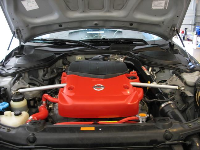

We put on the Motordyne 1/2" spacer, the Motordyne MREV2, and the APS tough boy strut bar today. With us being engineers, it took us a good 3 hours to do it all right (see below).
Problems with install --> No very good directions with the strut bar...had to revome a lot of clips and stuff and not a lot of slack on the electrical bundle...the motor cover had to be removed because it interfered with the new strut bar (Oh well, 0.1 lbs ligher!)...it did tighten up though...we couldn't get it really tight at 1st...after I drove it...I checked it and it got really tight. Also, I broke the PCV valve! When I was pulling the hose off the lower plenum, I pulled so hard, I broke the sonic weld at the PCV valve. At 1st, I thought we were f-ed because I didn't know what I broke, but when we realized what we did, nothing superglue couldn't fix. It's a $10 part and I'll get a new one tomorrow.

^^get that Randen ... you'll have to forgo the strut bar though

You don't have to lose the strut bar...look what this guy did...I'm about to do this to my cover soon:
Attached Thumbnails Motordyne MREV2 & 5/16 PLENUM SPACER-modified-engine-cover.jpg

Wow never seen that before, that's pretty cool...
