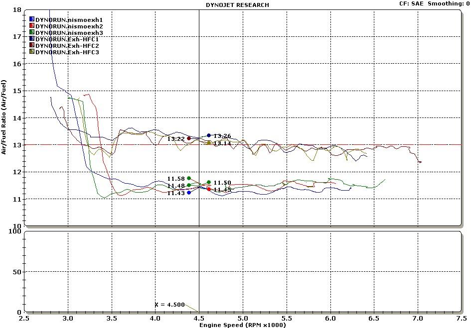

I have the metalic and I put it in the extended bung because the metalic do not operate correctly until they are at a higher temp than ceramic. They can throw a code during this warm up period. 10 minutes or so after a cold start. Mine have been in for months and no codes. I also ran it on the dyno and the A/F was great.
Here are my A/F before the HCF with just the nismo exhaust and then after the metalic HFC and Nismo exh with the O2 in the long bung.
The A/F is measured by the dyno not the O2 sensor.
top lines are with the HFCs 13.0 ish on 93 gas
This is on my 07 these runs were to set base lines so we did not run it to redline.
