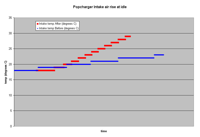

Actually.... wired had a pretty good log of intake temperatures.
Originally Posted by Wired 24/7
It takes longer than 1/10 of a second... at least 8 seconds or more.
When I datalogged at the drag strip, the intake temp did not reach ambient until I hit 3rd gear.
https://my350z.com/forum/attachment....1&d=1159392079
Notice the line of the Pop Charger versus stock airbox. That's a pretty big difference in slope.
It makes no sense eh? What does heat do? What can heat do with the hood open?
