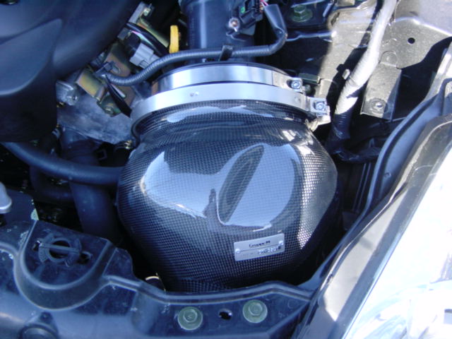

Top View

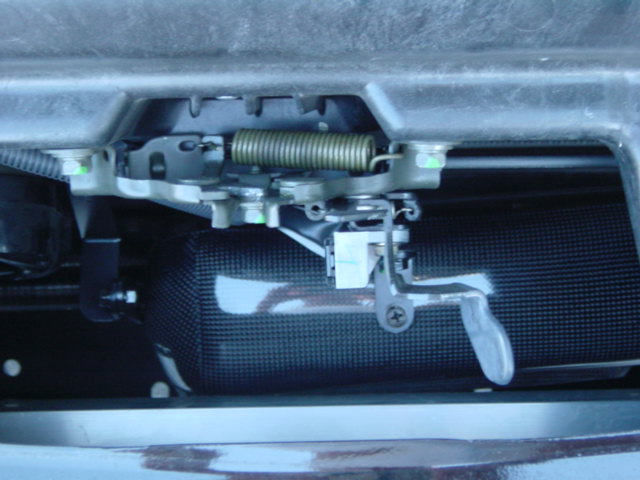

Hood Lacth

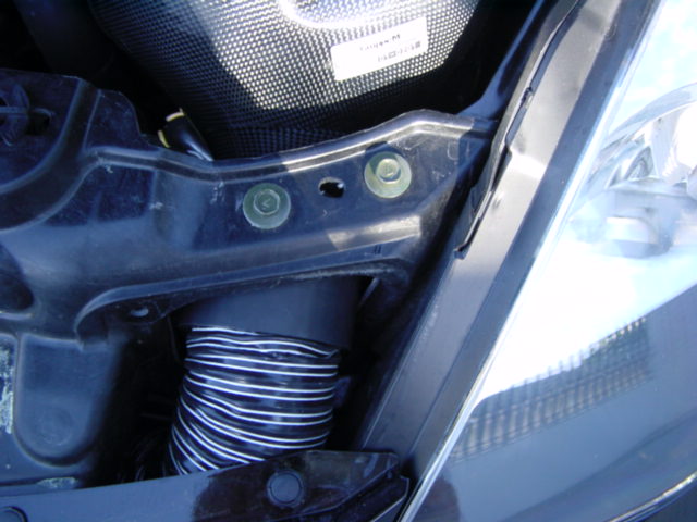

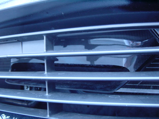

Ram air

Originally posted by chaknchngo
Ram air
Damn Dude ..How come your scoop hangs so low..???
