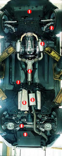

Our Z's have two cats - a pipe shaped like a Y connects to the two cats, and goes in to one , which connects to the mid pipe (that you were talking about gettin fab'ed for cheap), which connects to the muffler(s) depending on your set up.
there are variations of the Y pipe, you can get an X or H pipe if you went dual.. but really, pointless unless you are FI. this is why I don't think getting it fabbed is a good idea - our cat back systems actually include a new Y pipe as well in 90% of what I have seen.
I believe the stock tubing is 2.5" already...

does this help? 3 are the cats, 4 is the Y pipe, 5 is the mid pipe with a resonator i believe.
