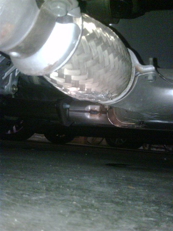

So my current driveway is fairly steep so my y-pipe barely scratches, after about 9 months of living at my place (and driving in n out) I finally have a leak in my stock y pipe (it seems to be from the flex joints).

Attached Thumbnails Exhaust y-pipe leaking on G35! What to do?-img00110-20081123-1249-small.jpg   Exhaust y-pipe leaking on G35! What to do?-img00111-20081123-1249-small.jpg

I knew because it my car started sounding like a Subaru. It sounded throaty and sounded like it coming from under my feet, so i looked under the car and the flex joints had holes. It was pretty obvious for me.
if u think it's a small leak, u can take a long flexible tube, put one end near ur ear, the other around ur y pipe and listen for any hissing.

Just for FYI purposes: Broke down and took the car to my local muffler shop , ( been there a couple of times ) and had them check the car . good news : even if Y pipe has holes on the mesh area on the outside there are a couple of tough metal bars underneath the top layer and 2 other mesh layers underneath that, so even if the top has been scrapped off ( like my mine )the y-pipe won't leak. Bad news : one of the resonators on the megan test pipes has kinda broken loose . And yeah talk about unavoidable flaw in the drive way - I want to take a sledge hammer to it.
