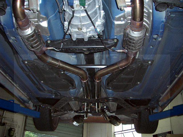

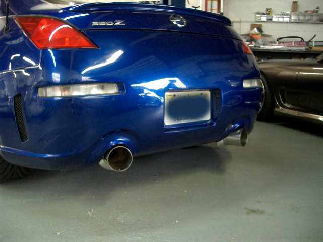

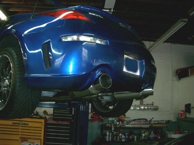

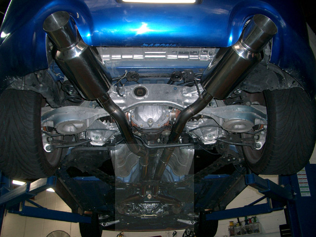

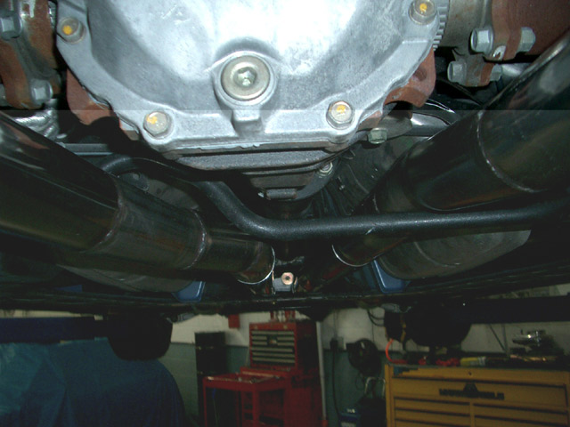

OH MY GOD. 1st thing i need to say is it is not finshed. Way too loud. I am talking unmuffled territory! So i will go back tomorrow to install resonators.
But same thing as the y-pipe, great craftsmanship. We used 2.5 inch piping from header back. And the only thing restricting airflow were the two hi-flow cats.
Take a look at the photos. Honest to God, it sounds like JGTC car. If i had another daily driver I would leave it, but its too loud for everyday cruising.
