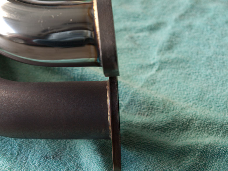

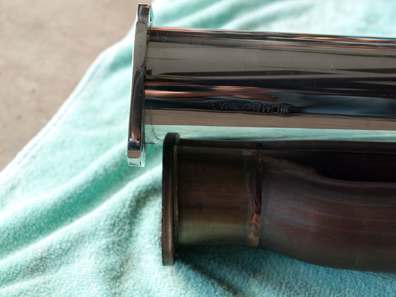

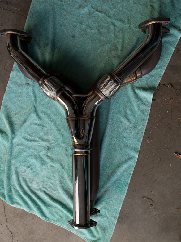

For a long time I have felt that early 350Zs must have had slightly different exhaust hanger positions than later cars (maybe the factory switch in 04?). The reason I thought this was because I have seen more than a few different companies produce exhaust systems that seemed to hang lower on one side than the other on many 350Zs. My own experience with this was with the Injen and Nismo systems on my 2004.5.
Heat cycles and tension will cause cracking, so normally when installing exhaust you start at the front and attach each piece loosely and then tighten it all up so it just hangs there, unstressed.
This last weekend I decided to change my Nismo Y pipe with the Motordyne XYZ and discovered something interesting. When I disconnected the bolts on the output side while leaving the rest of the system in place, a gap formed that was almost an 1” between the Y and the mid pipe. The means that the Y pipe and cats are being pulled on by the rest of the exhaust all the time making the situation ripe for cracks to occur.
My suspicions were then confirmed when I placed the XYZ pipe on top of the Nismo and found that it was in fact longer by about an inch. The XYZ also fit between the cats and mid pipe perfectly.
My Nismo Y is the earlier non-gusseted version, don't know if that makes a difference or not.

hanger positions are the same on all year cars as far as I know, though the stock hangers are prone to going soft (even softer than they are stock), which can lead to things drifting a bit
I'm swapping over to the NISMO exhaust hangers shortly, as soon as my new pumpkin goes in. Unfortunately they don't do them for all the hangers (1 of the hangers is odly shaped as you know) - but they are considerably stiffer than stock

this is a very well known fact on here that the nismo y pipe causes cracking in aftermarket high flow cats and test pipes...many many threads on this
