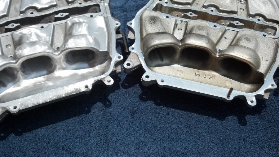

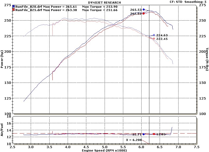

Not saying it's the same as the MREV2, but I snatched a used non-rev DE lower plenum and went to work on it myself...took 5mm off of the front 2 runners and smoothed out all of the casting lines.
Attachment 426998
Attachment 426999
Mine is an 03 DE, but still saw a decent gain throughout my entire powerband. Both HP and TQ. I'd say it's definitely worth doing if you're running a Revup...I'm curious to see what my plenum would do on a Revup.

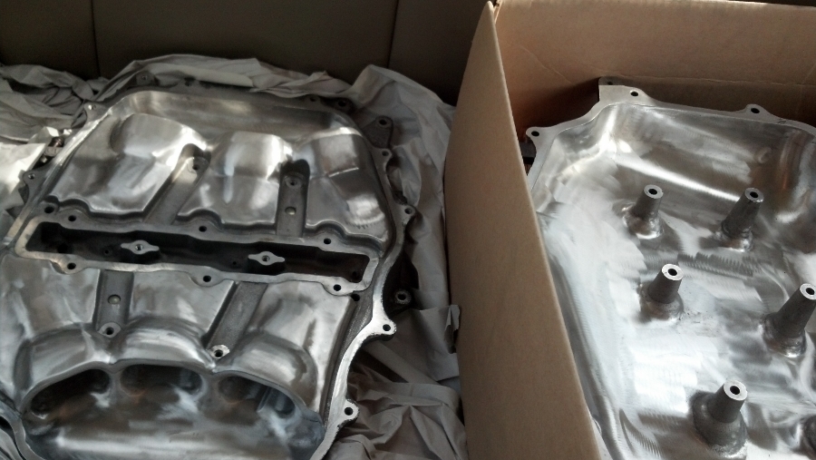

I also did this for my rev-up. Both halves & widened the throttle port.
