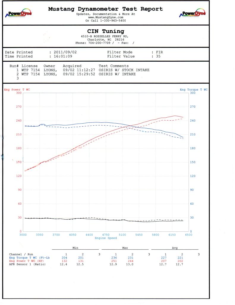

I will be dyno testing this manifold on friday. My current setup is VQ35DE (G35 auto sedan), 5/16th spacer, revup air box, HR y pipe, HFC, and coupe midpipe, 100shot of zex. My car is untuned and running lean. I will first, dyno it as is, get it tuned at CIN using osiris, then swap manifold, tune and dyno it again to see the gains.
Any questions or suggestions?
Old Aug 31, 2011 | 07:06 AM

I tested this manifold against a stock manifold with a 5/16th spacer. My car is a 2005 G35 Sedan Auto with VQ35DE. Mods are kinetix cats, HR Y pipe, Ztube, 5/16th spacer, Rev up air box. The car was first base lined, then tuned. Manifold was installed (car stayed strapped to the dyno), car was retuned and dynoed again. Manifold didnt give me any power. I lost power thru out the band. It does look like the manifold might have made more power if I rev the motor to 7200. My car is a DE, with stock valve springs, and 127k miles. Revving that high aint safe. The stock manifold with a spacer gives more power thru out the power band.

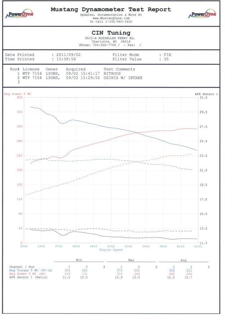

I also tested this manifold with a 100 shot of Zex nitrous using a single fogger. Zex rates their shots at the crank, so at the wheels its maybe a 80hp gain. Using this manifold and the 100shot, I gained 71hp at the wheels and 142 ft-lb of torque. Torque was very very high.

Thanks for posting your results! We never did get to test it against a spacer, only a stock intake manifold.
