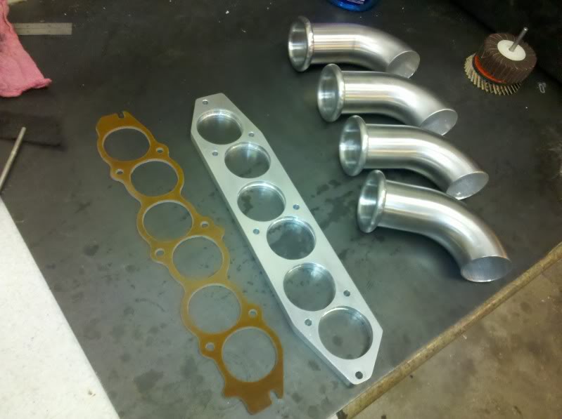

Did you include velocity stacks in your's?

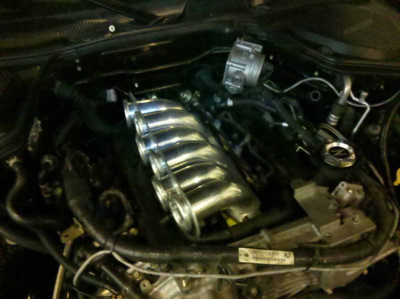

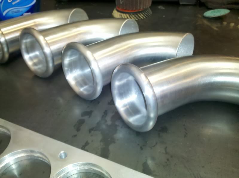

Yes

Cool, I take it back. Looks efficient, now the real test: Flowbench, dyno, or both.
P.S.
Did you take measurements of the runner lenths and diameters stock and modified?

I'm not seeing the rear cylinders starving, but I have a little bit of a question about velocity. The collector area looks like it may cause a bottleneck depending on the interior wall and horns setup. But, aside from that looks like a great prototype.
The Fontana guys used what I think is the best design for outright peak figures.
So hot...
