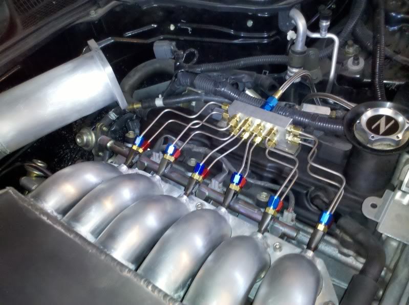

The only way the nitrous nozzles could hit the fuel rail is if they were installed upside-down.
See this picture, if they are not installed correctly it will hit the fuel rail.

I spoke with Muzzy on the phone early this morning and decided that the problem is related to his aftermarket fuel injectors. The aftermarket injectors sit taller than the OEM injectors, thus pushing the entire fuel rail up almost a half inch. This system was never designed with aftermarket fuel injectors in mind - especially because you can purchase aftermarket high-flow injectors that are the same height as OEM.
Problem solved - now Muzzy is on the look out for a spacer for the intake manifold.

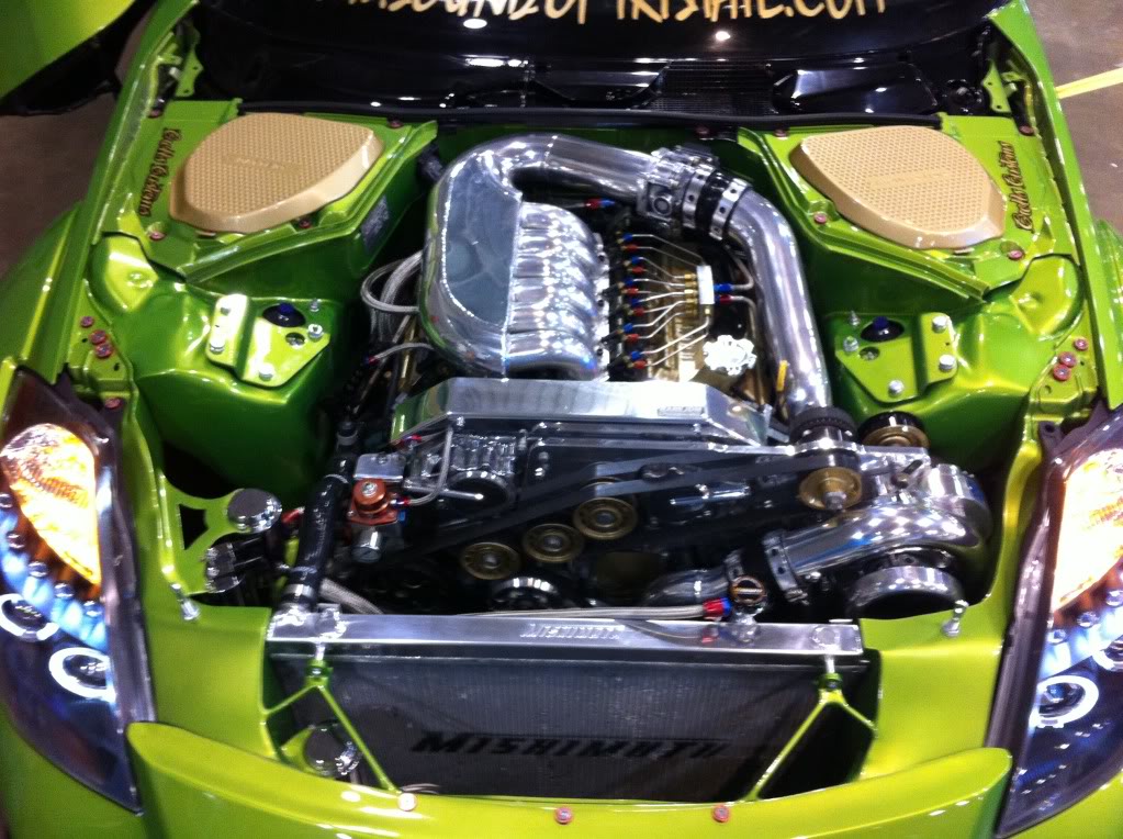

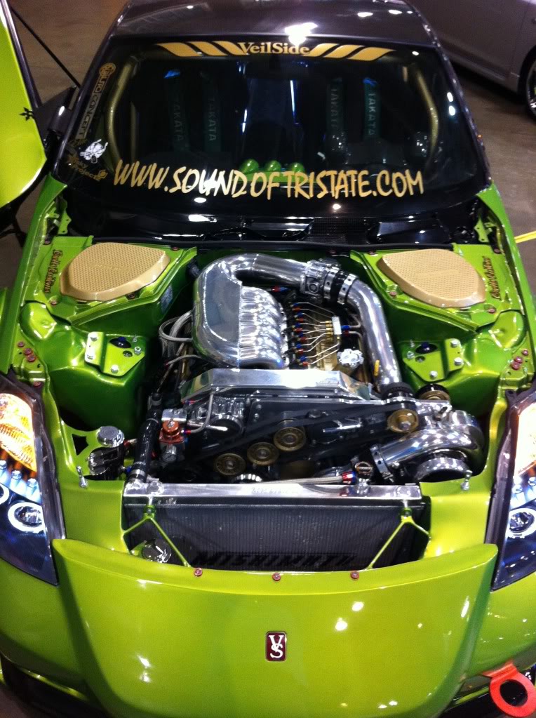

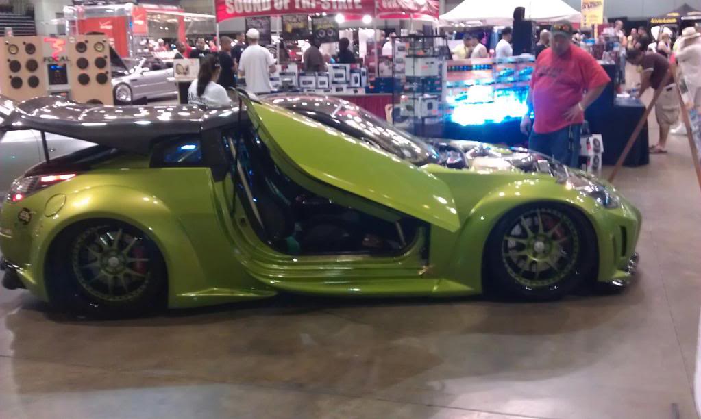

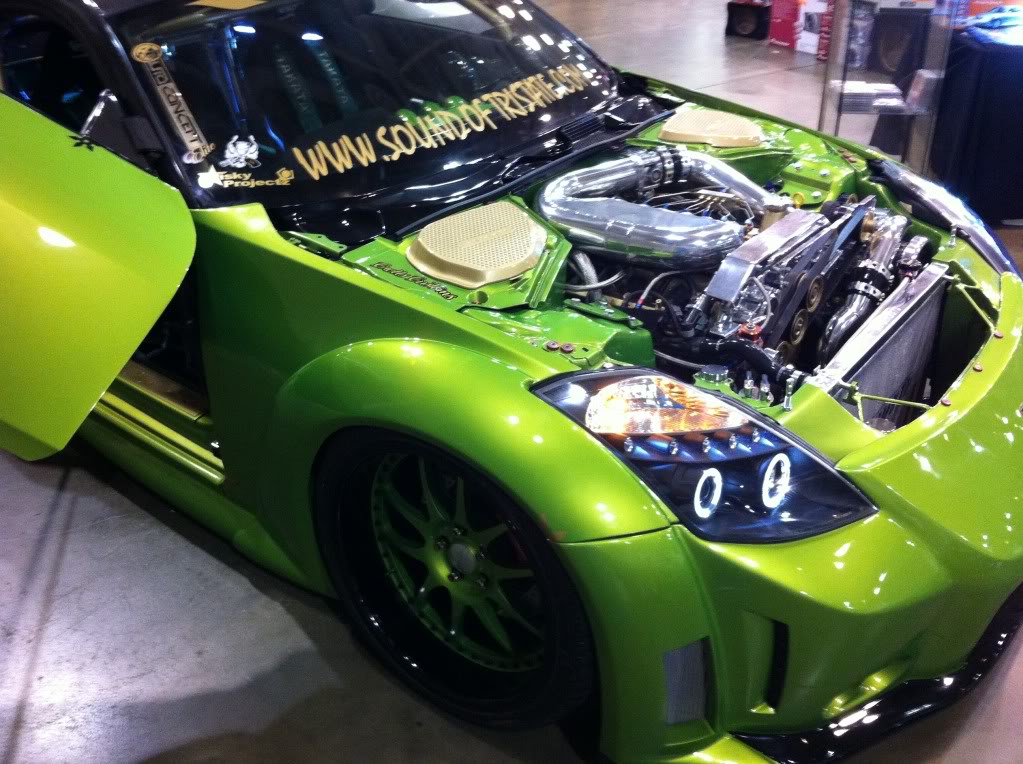

Muzzy just posted new pics of his ride and I thought it would be appropriate to see where the last Street Solutions manifold that was built was used:
