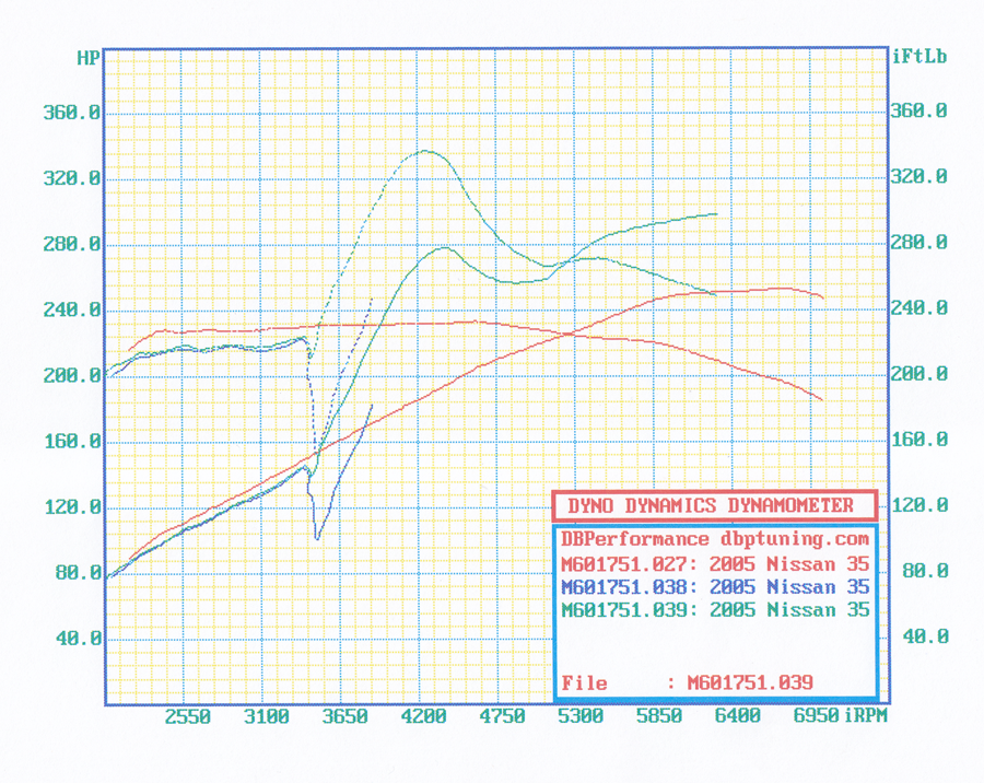

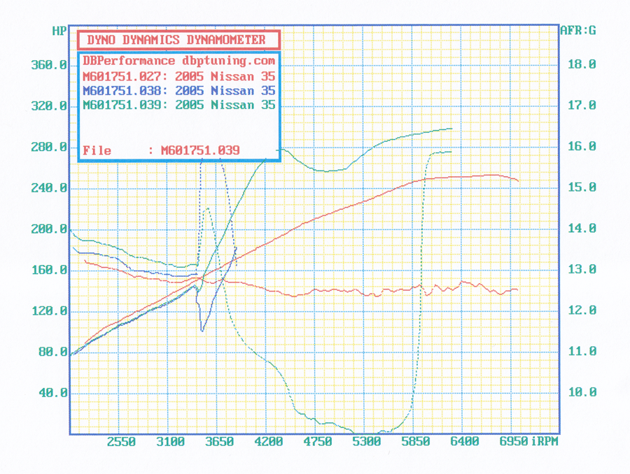

Here is the botched nitrous run. As you can see we barely got into it and managed to pull 320hp anyways. I think 375 is easily attainable.
This graph shows HP vs. AFR. Notice first it spikes lean really hard like a dry shot and then gets insanely rich. This is showing the 500 RPM lag between the nitrous kicking in and the fuel coming into play.
