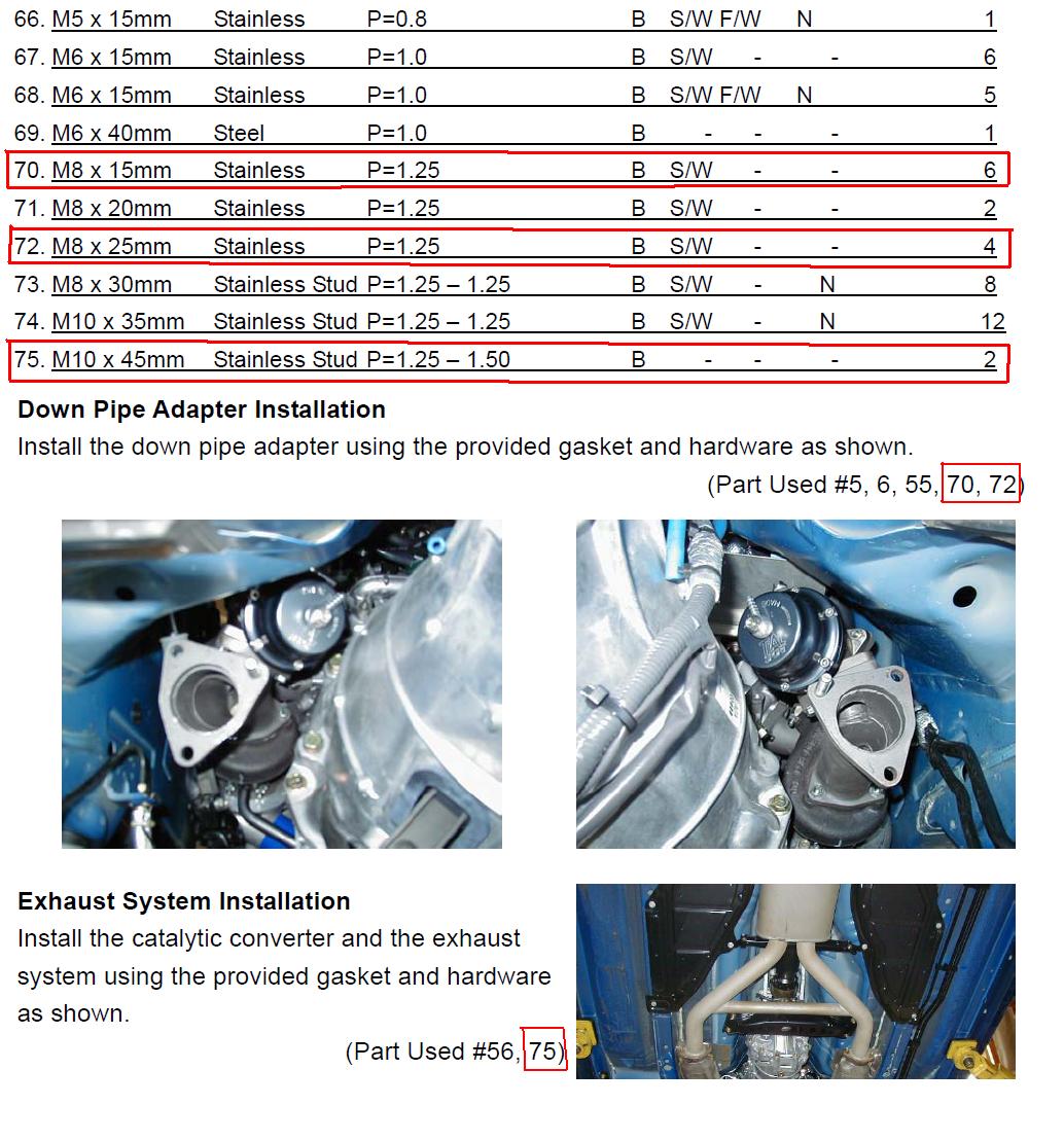

This may or may not help but in the Greddy TT Install manual, the 2 studs they provide for down pipe/Cat install are;
M10 x 45mm Stainless Stud P=1.25 – 1.50
But; in there shitty instructions; they also use;
M8 x 15mm Stainless P=1.25
M8 x 25mm Stainless P=1.25
So basically 3 different lengths LOL
Ugh, worst install manual ever.

The only reason I offered the others is because the kit only included 2 of those M10 studs.
Confusing, I know.

^ okay, im guessing it must be #74 then???
at 35mm length...im think im good then..ill verify today when i do the HFC install..

Okay guys I confirm that 1.5 inch length is more than enough.......
I failed in that i didnt measure the two flange widths but its a moot point....
So to reiterate:
Dia x length
SAE:
3/8 x 1.5" length work just fine.
Metric:
M10 x 35mm
Once again:
For a typical HFC or test pipe install you need 8 nuts and bolts, lockwashers, cut washers, etc as needed.
if your HFC or test pipes have the flange to connect the cross brace then you need 2 more additional nuts and bolts making the total 10 needed. these two can be much shorter than 1.5" length as the cross brace isnt thick at all and usually the flange from the HFC/testpipes isnt either. Just some fyi.
