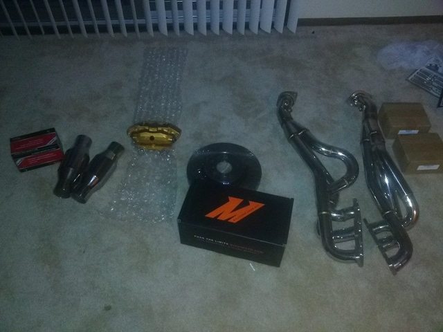

Well, i can tell you that the set i ordered here:
Amazon.com: OBX Exhaust Header 2009+ Nissan 370Z VQ37VHR Long Tube: Automotive Amazon.com: OBX Exhaust Header 2009+ Nissan 370Z VQ37VHR Long Tube: Automotive
Wound up looking like this:
and don't fit.
Again, they don't clear the inner firewall on the driver's side and bottom of the car.
If you'd care to try yourself, feel free. I'm selling them, because I've got no use for 'em.

I hope that isn't what mine look like.

My replacement PPEs showed up on friday, and went into the car yesterday. I did some comparison photos before I put them in so you guys can see some of the differences.
http://imgur.com/a/ondQo
The PPEs are a much tighter design, and the primaries are considerably longer than the OBX units. They have much better clearance around everything, except the bolts holding them to the engine.
