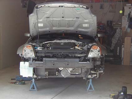

there is NO bend other than the natural bend in the tube. It must be lighting.
here is another
Attached Thumbnails Kinetix Racing Plenum Dyno's!!!!!!!!!!!!!-injeninstall3.jpg

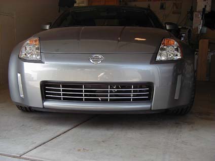

Posts: 1,721
From: Copacabana, Rio de Janeiro BR
what the heck. here is it down in the grill...
Attached Thumbnails Kinetix Racing Plenum Dyno's!!!!!!!!!!!!!-finished-install.jpg
Old Feb 10, 2004 | 07:30 AM
  #103
was wesman's Avatar
was wesman
Posts: 406
From: 21 Boost St DFW,Tx
post a shot of how you have it meeting up to the piping? What makes it hybrid ? Is it just located there rather than in front of the wheel ?
