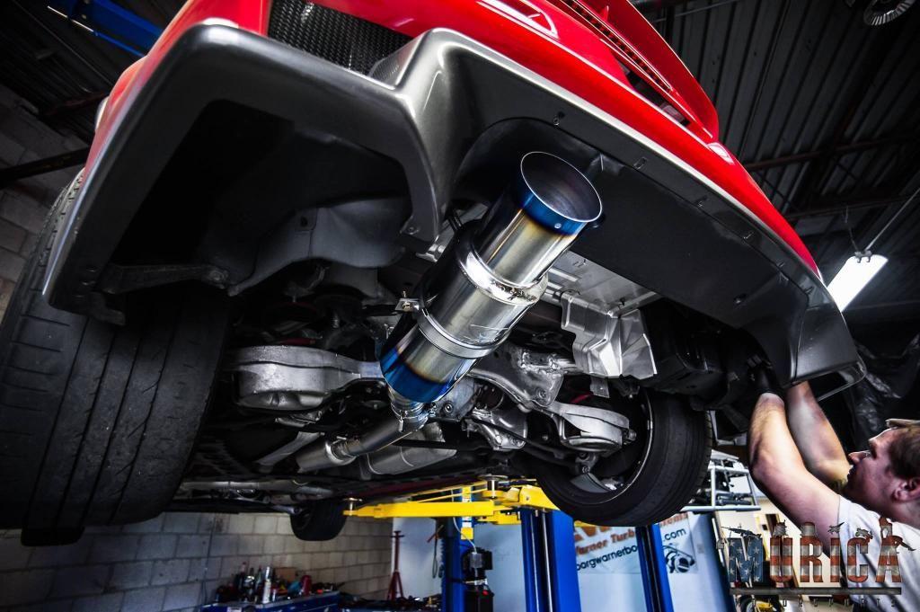

Dcains, I believe this is the thread you're referring to. OP, check out the the threads linked below, you may find what you're looking for. It appears the hangers on the OEM Nismo and the S-Tune are angled different. I suspect this could cause some fitment issues with the rear Nismo diffuser.
1. https://my350z.com/forum/nismo-350z/...the-nismo.html
NOTE: I would give fitment a 9 out of 10 on the Nismo, as the muffler hangs lower than the stock one. This makes the muffler come into slight contact with the top part of the diffuser (just like the HKS does), adding the potential to melt it. This upper plastic piece could either be trimmed (1/4in) or simply removed. The contact is so slight, I am just going to run it as is, without modification, and see what happens.
2. https://my350z.com/forum/nismo-350z/...e-exhaust.html
I saw a picture about a year or so ago with a normal z that had the nismo body kit added to it and had the s-tune exhaust. It looked like crap and I wish I woulda saved it so I could show how bad it looked.
The factory nismo exhaust is tucked up and mostly hidden by the bumper, but the s-tune hangs down just like the standard z muffler and is completely visible on our cars. The tips looked fine. A little on the small side, but not too bad. It was the way the muffler was laid out what looked bad. The normal Z rear bumper hangs lower and makes it look good, but with how open our bumpers are it just doesn't fit.

I love the look, sound, workmanship, and weight savings of the Tomei titanium exhaust. Best out there imho...
