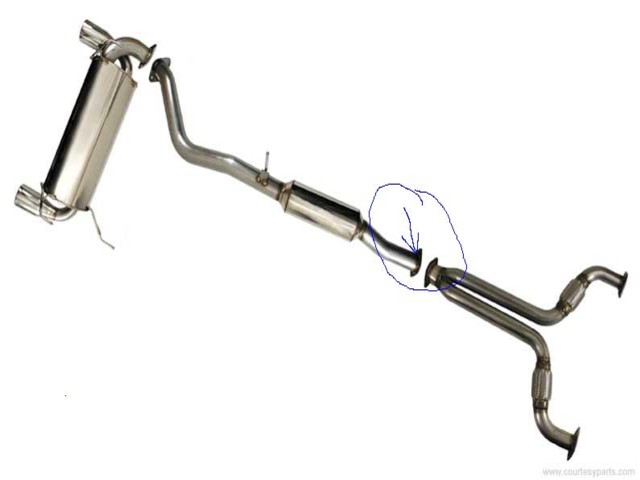

Went to go take my 'Z' for a ride got to the end of my street heard some rattleing under my car. Did a 'U' turn back to the house and jacked the car up and this is what I found the middle pipe on my nismo exhaust broke right off at the weld.Has this happened to anyone else? Called jeff at performace nissan from where I bought it and he took care of it sent me a new pipe. That place is great.

7000 miles on mine no breakages yet... how many miles did you have on yours?

I installed the exhaust when it had 4000 miles in august of 03 now it has 25,000 (i drive alot) and it broke right at that weld. I'm wondering if I just got a bad system. When I install the pipe I'll have to check the muffler and the "Y" pipe real close. Hopw everything is good. I don't want to call jeff with more bad news.

Yes check it out. Thats the same noise I heard, Then the pipe broke eventually.

On the beginning of the Ypipe i have some bracket welded on. I think this is on the later models of the nismo exhaust. I think its a weak point (the section were your exhaust went bad) of the exhaust cause it scraps the ground sometimes.

yeah the later models, like mine's, has a bracket welded on top of the beginning of the y-pipe.
I've had my nismo exhuast for over 12,000 miles and it's been a champ.
