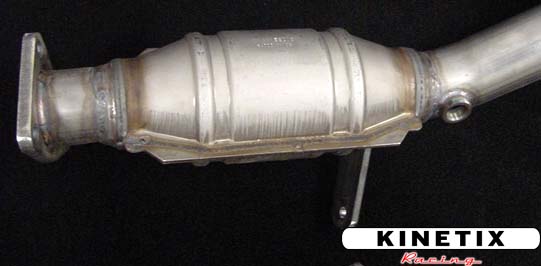

If you are running , or plan on a TT setup such as Greddy which has a cast iron downpipe, adding a bung thre is not an option.
Though there isn't much space, a bung can be welded pre-cat , on most aftermarket hi-flow cats. It jsut reuires some manipulation of the CAT heat shielding.
Old Jun 23, 2004 | 11:36 AM
ChrisMCagle's Avatar
ChrisMCagle
Posts: 1,612
From: Massillon, OH
Default Re: O2 bung location
I read this post a few times and then it hit me what he meant and it's a great idea. Unless I am mistaken, you mean something like this picture I photochopped? My only question is can this be done while installed on the car, or does it need to be done off the car? I am just wondering how they make the hole in the pipe before they weld in the bung? Do they drill it out or use a plasma cutter? If they drilled it, I would be concerned with the shavings doing some damage. Or is that not an issue?

G3po's Avatar
G3po
Posts: 1,635
From: Nor Cal.
Default O2 bung
Yes , like shown on the Kinetix CAT. However; the bung shown is for the OEM pre-CAT sensor. Another bung needs to be added
in that same vicinity. Many have done this, I'm suprised none have responded yet. Actually if you by the Crawford Cats he'll
weld and extra bung in , for a small fee , before shipment.

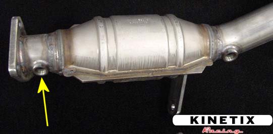

No, actually that is the extra bung that I photochopped onto the picture. The stock Kinetix cats (which I have) do not have the extra bung there (like in this picture). The pre-cat sensor is actually on the stock manifold downpipe.

I stand corrected. Yes , do what was photo-shopped.
I would have to be done off the car I am guessing. Aside from the debris you mentioned getting into the cat, it would be nearly impossible to get a leak free weld the whole way around the bung while the pipe is on the car.
Old Jun 23, 2004 | 02:20 PM
ChrisMCagle
Posts: 1,612
From: Massillon, OH
Default Re: Re: Re: O2 bung location
Well... CRAP! That's not what I wanted to hear. It took me 8 hours just to install the darned things. I might swing by a place near my house and see if they think they can do it while the cats are installed.I REALLY do not want to have to put the stock cat back on the passenger side just to go get a bung welded.
