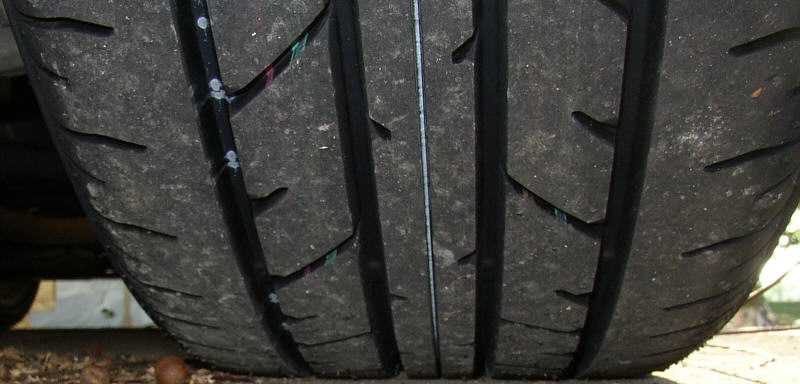

Pics of tires on this link - both snows and the orgs
http://homepage.mac.com/stracy01/G35...toAlbum91.html
In use
http://homepage.mac.com/stracy01/G35...oAlbum105.html
the Pirellis work pretty well

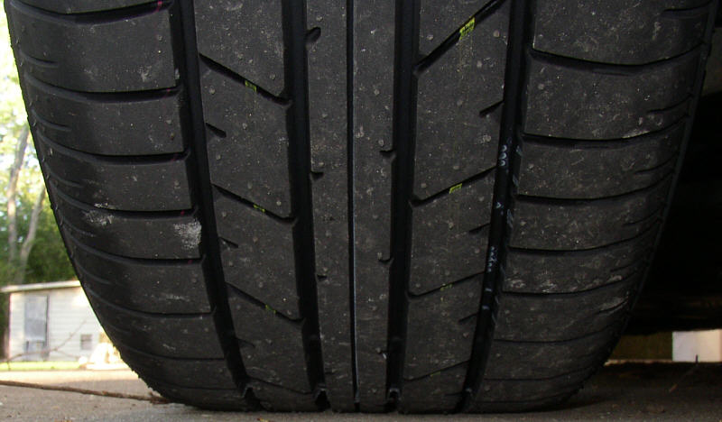

My Z tires right after the TSB side to side swap - so the former inner sides are on the outer, a bit misleading
http://homepage.mac.com/stracy01/Auto/PhotoAlbum12.html
I now see the difference in the new tread - a good idea IMHO. The old tire had Soft completely cut blocks that do squirm around a lot.
- Steve
