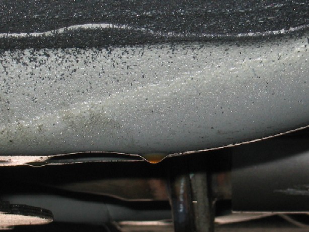

Well, I just crawled under the car and to my surprise.

That definitely looks like a leak!

So that's what they mean by engine (exhaust ) coating
which causes that burning smell

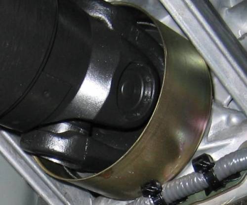

I dropped off the car at the dealership this morning for them to check the oil leak and the throw out bearing noise. I was told by the service advisor that it's the extension housing seal that's leaking. The leak is dropping on the exhaust and that's what causing the burning smell and smoke. Anyway, he said that they contacted Nissan and they're waiting for the engineer(s) to show up tomorrow to take a look. He didn't just want to change the seal. Regarding the noise, he told me that it looks like the front input bearing is causing the problem. But, I would say it's not for sure. I took a couple of pictures while he was showing me the leak. I'll post them later tonight. It was a pretty healthy leak. Hope they can find a fix soon. Only have 730 miles on the car.

Just got an update from the dealership. Nissan engineers didn't show up yet . I was told that they are researching these issues. Meanwhile, they were told to order a new transmission and drive shaft for my car. Who knows when the parts will be in though. I am gonna go and pick up the car this evening. I guess I can drive it without worrying what happens to the transmission.
Here's a pic of the drive shaft. You can see the leak at the bottom.
