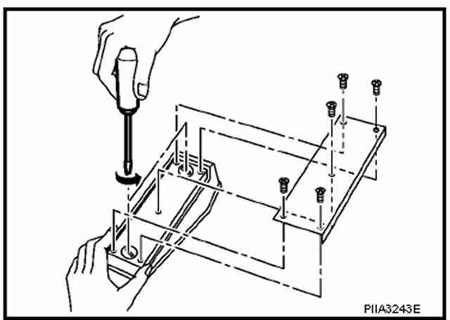

The foot rest installs on two pegs. Inside the foot rest (after removing the 5 screws and top plate) you will find two dials. They lock and unlock the footrest in place with a half turn.
As a practical matter, your foot only puts downward pressure on the foot rest, so it stays firmly in place anyway.
NOTE: The foot rest must be removed if you wish to access the fuse box to the left.

Illustration from Service Manual:
