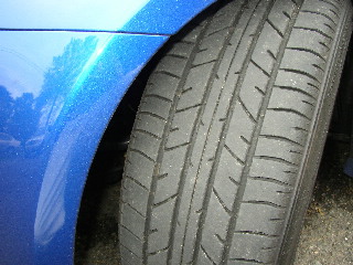

5300 miles.
This is my front left tire.. looks clean.

5300 miles, no tire feathering so far.
Can anyone post the pic of tire feathering?
Like to see how bad it is.
Thanks,
