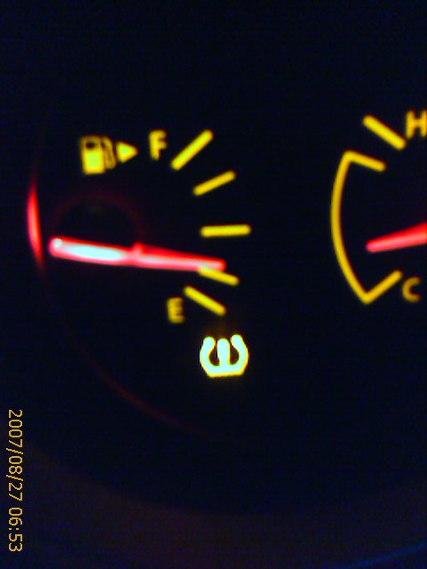

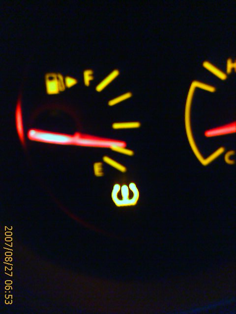

i just got this car from nissan showroom 2 weeks ago.. its a 2006, 44k miles on it.. and this sign popped up this morning.. i think it has to do something with oil? but the oil change is due on 48k

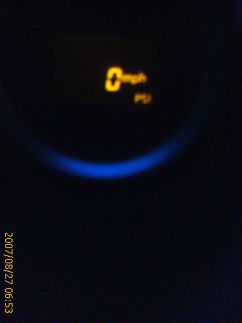

the speedometer this says SPI.. dont know whats that suppose to mean..
someone help me out thanks..

search is your friend. low tire pressure for the first two pics. I'm assuming this isn't a joke post to try to get a bunch of people in here flaming you...

Yea def tire pressure. Its on in my car bc i guess im running 275 40 18s. Dont worry about it unless u have stock rims and tires.

either your tire is low on pressure or you don't have tps on your aftermarket rims.
that will light up for either

Joking. Just means your tire pressure is off. I have after market rims with out the TPS on and the light only comes on after driving for about a hundred miles. Turns back off when i turn the car off though.

Find out which tire needs air. Look in you manual to see how to rotate through the displays of your trip computer. It will show you which tire is low, but you usually have to be going over 16mph for it to give a reading on all tires.

maybe you picked up a screw too.....if you click the side button you could check your psi to see which one is low.

wat side button? i see PSI or PS1? in the speedometer thing (in the 3rd pic)

psi means pounds per square inch. it's referring to air pressure in the tire. which is low. so put more in. should be manageable.
