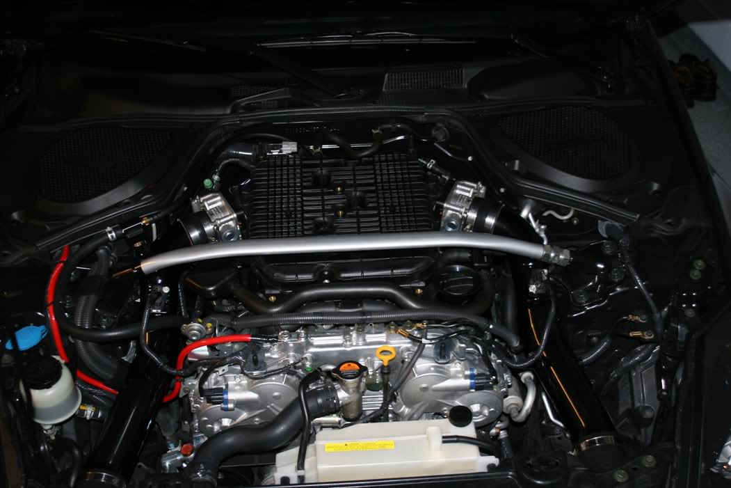

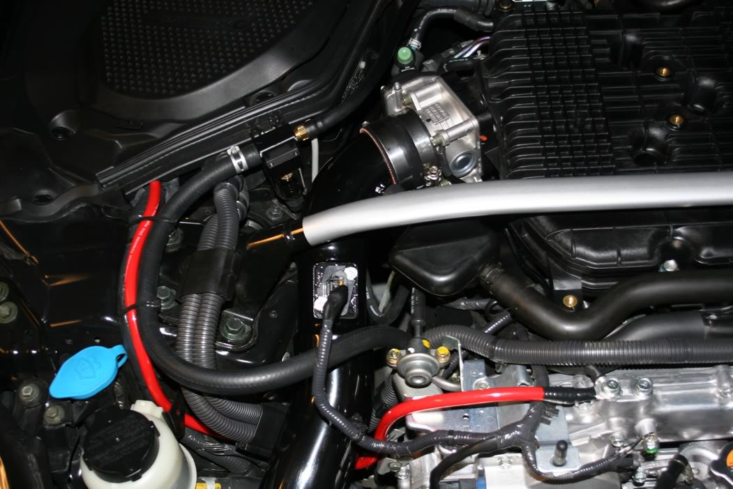

here are the 3 things that i have done.
1. cobb ap - Stage 2+
2. from 10w40 to 5w30 same 300v
3. oil catch can.
EDIT:
Some other stuff:
1. Bypassed throttle body heater loop
2. HFC and full Y-Pipe Catback
3. FAKE EVAP Canister - that was AMUSEing
4. Injen Intakes
5. 3 more ground points one fat one from the Negative and 2 to TBs
That's about it.
