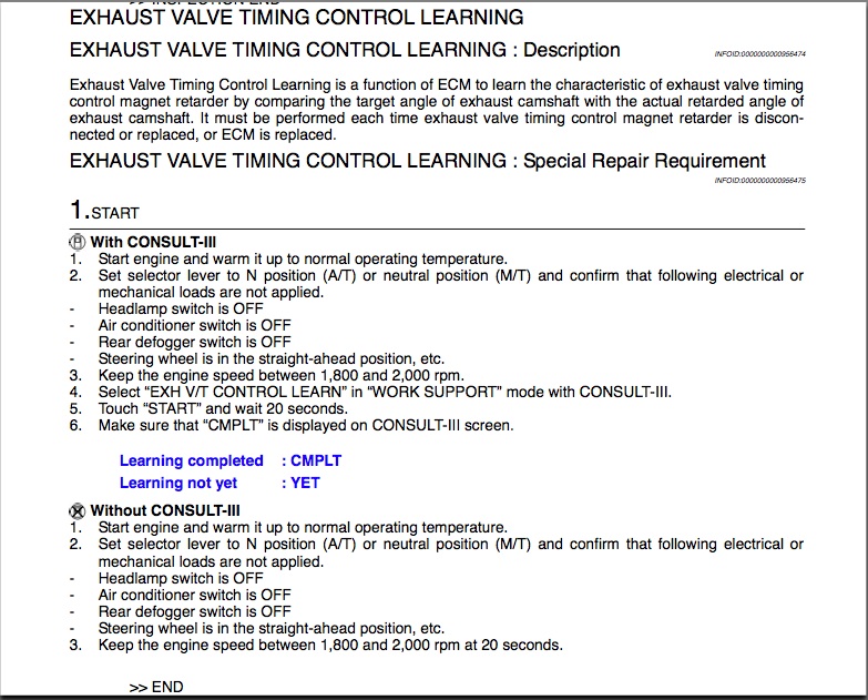

Setting my entire cam phasing table to 0 on uprev fixed my issues (but disabled VTC)
So I peaked through the FSM and found what I have attached. Let me know if it helps you guys.

Go through procedure E-71, in the FSM diagnosis by symptom section. If you have a real scanner this should be easy. Need to watch the timing, knock signal, misfire counters if they are there.

I remember may exhaust cam phasing table is all zero in the Haltech map Hal sent me. I never had the problem after I installed the Haltech!!
Maybe its the problem!!

the advancement or retardation of the camshaft is controlled with oil pressure via a VTC triggered solenoid. so yes, oil pressure and the cam phasing maps on the ecu Rom are linked.
there was also a TSB that suggested checking the engine oil pressure before troubleshooting of the VTC system. that, and empiric replacement of the vtc gaskets (they are pretty cheap) seems to be a good step moving forward for most of you guys.
the passenger side VTC cover has been revised. there is now a larger oil gallery/reservoir thingy on it. the TSB suggests checking oil psi before you attempt replacing this...its an expensive 400 buck part
