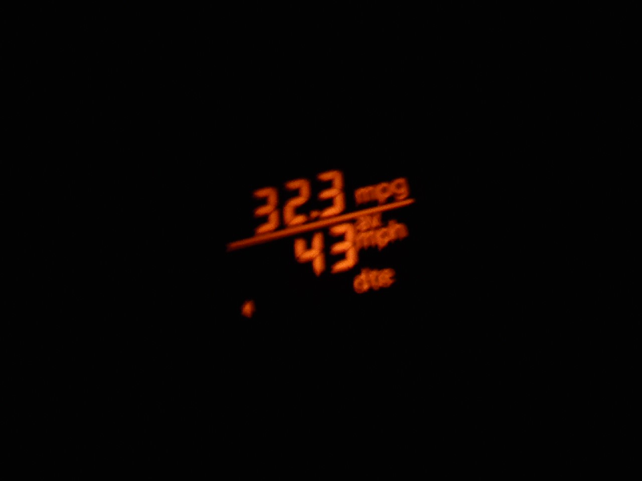

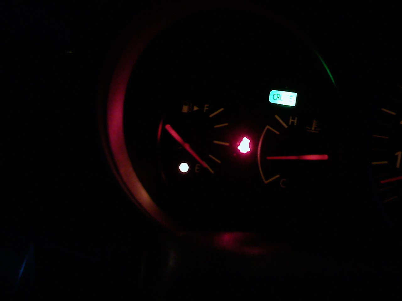

Anyway, after a week I finally hit the gas light for the first time on the way to work. After work I drove about 15 miles home to see the gas station thats always open, was closed. The one across was also and so was wawa's not even half a mile away. My fuel gauge said i had 19 miles to empty at 24mpg. I figured I would risk it back to the route 9. I set the cruise and was gettin 32mpg at 50. It was about 20 miles away but the gas gauge was blinking 12 until empty. Just as i pulled in the gas station closed, I went to another one 5 miles down and told him to fill it up. Now this still doesnt seem normal and im sick and tired of Freehold Nissan's ********. I'm going to have to schedule an appointment now. Take a look. It took 15 gallons... almost. EDIT: I floored it WOT multiple time before getting to the first gas station, I wanted to be as empty as I could, then still had to drive all the way back the other way to get gas. No way I have 5 gallons left when the gas light comes on.

i told you its a built in buffer. It is basicly so you will have enough gas for about 40-50 miles to get to a gas station.
I mean personally. I think thats great because if other cars said low on gas then 5-10 minutes later. Ran out of gas. I'd be very bummed. But instead I have a buffer zone of 2-3 gallons to get to a gas station.
I mean if it does bother you. Go to a dealership and tell them to get you a new ECU, fuel tank, and fuel gauge(which will still give you the same symptons you dont like). They cant replace one tiny part in your gas tank. The computer makes calculations based on whats left in the gas tank. With a potentiometer. Which is basically a variable resistor when it gets to the bottom it will display the Low on Fuel light. But the actual gas tank is larger then the potentiometer can read. By about 2-3 gallons. giving you time to get to a gas station.
And the computer is programmed to calculate by the potentiometer in your gas tank to give you, your mileage based on multiple sensors in your car. But I might be wrong if I say that it has been programmed to also include the extra fuel in the tank.
If you dont believe me go ask a dealership. If I'm wrong, come back and tell me.

After having my fuel gauge more or less stop reading correctly (I drove 150 miles with the gauge at empty, light on, etc..., I had the Nissan dealership look into the problem and they replaced the upper and lower fuel level sensors. At that time, I was told that the factory calibrates the system to read for an 18 gallon tank, not a 20 gallon tank.
Not sure exactly how true this is, but it does kind of make sense when seeing the gauge read empty and only fill up 14 gallons.
