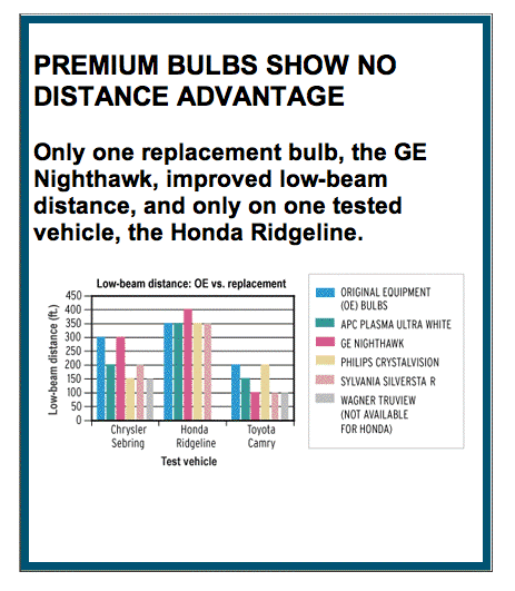

After market bulb manufactures make big claims. Do not be fooled. Many under perform OEM bulbs.
While that may be true for standard halogen bulbs, none of those are actual D2r or D2s bulbs.
Besides, the HID bulb is controlled by the ballast, which is 35w. So, if you run a Philips 85122 or an Osram, you're still going to have 35w of output.
Now, switching the ballast out for a 50 watter, will make a significant change in the output, no matter what bulb you are running.
-Tim
