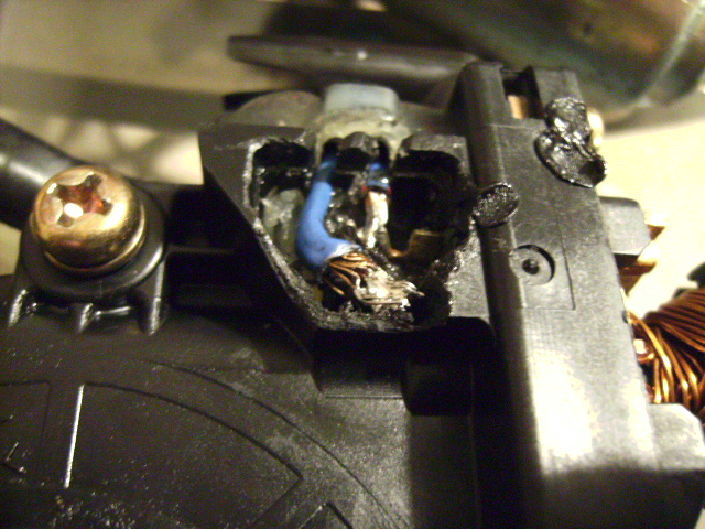

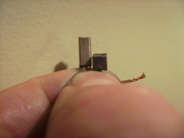

Ok, so with all this crap about the window motors not being rebuildable on our cars i decided to try it out. These are small electrical motors and like all other vehicles they can be repaired. This is also obvious by the fact that they sell refurbished motors. SOMEBODY repairs them.
I went to a local hobby shop that sells parts for RC cars. I purchased a set of electric motor brushes at a huge 0.79$ pricetag for each.
The rebuild wasn't hard. The worst part about it was removing some sticky goo off the side of the of the case which houses some wires. Then the wires have to be unsoldered so the whole brush assembly can be pulled out the top.
I didn't take as many pictures as i should but here are a few. Pics of the old brushes, pics of the new brushes and the assembly. The old brushes were worn down to only about 3mm long which is small. I had to do a little sanding on the new brushes a small amount to make them move smoothly.
Attached Thumbnails Window Motor repair, they can be fixed!-sany0994.jpg   Window Motor repair, they can be fixed!-sany0997.jpg   Window Motor repair, they can be fixed!-sany0990.jpg

can i ask what steps you took to unsolder the wires, my brushes are completely worn down to the point that one of them is flush with the wall. it's useless to just clean it. i'm pretty sure i can find the brushes at the r/c hobby store but i just need to know exactly how to pull it out and remove the brushes. thanks!
Old Feb 26, 2010 | 08:32 AM
binder's Avatar
binder
Posts: 6,457
the middle picture on the first post. You have to clean the protective coating out of that then desolder those wires from the posts. It takes a while and sucks but they have to be perfectly clean. Once the posts are clean you can pry the plastic part that contains the brushes out of the motor can. Those posts have to slide up through very small slits therefore they have to be perfectly clean with no solder on them.
Once you do that you'll see all the other areas you need to solder. Just cut the wires from the stock brushes and solder in the new brushes where the old ones were.
ask q's if you are still confused.
