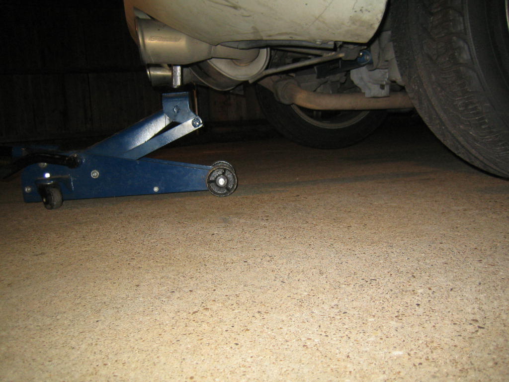

This is exactly what u need to do...you need to lift from the diff under belly with out contacting the fins.........when you lower the car, you also have to do so gradually because if you slam it down the suspension will compress and you can still hit the fins............
I have the nismo diff cover and used to do this.......i still one time while rushing managed to break one of the fins......
I then later designed a hidden hitch and then made a straight shaft -center jack point - so to lift the car rear up to where i can change both rear tires at the same time at drift events.
It serves as a hidden hitch and later can put this solid shaft in and use it as a jack point. You can see the nismo diff cover in the pics.
PIN STAY JACK POINT:
IF you have an oem exhaust, or an oem like exhaust you can easily remove the rear pin stay and have a local welder weld a shaft that hangs down to a point that cant be seen but you "KNOW" is there.
Rear pin stay is this part:
It's held in with two 17mm hex head bolts (shown) and two 19mm hex nuts at the subframe mounts on each end. you can remove it and take it to a shop to have a center lift point shaft welded on that hangs down out of sight due to the oem like exhaust can hiding it.
-J
