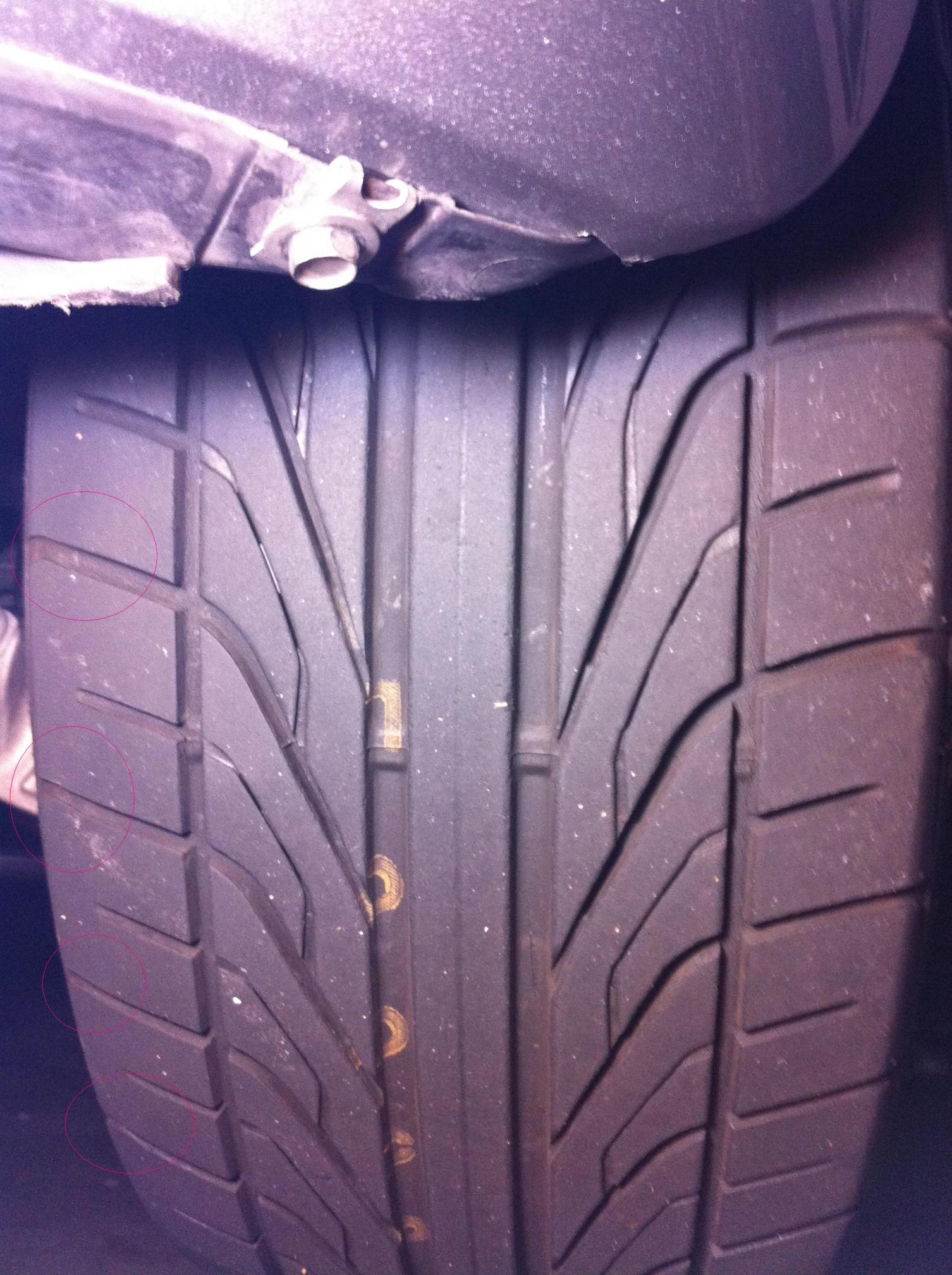

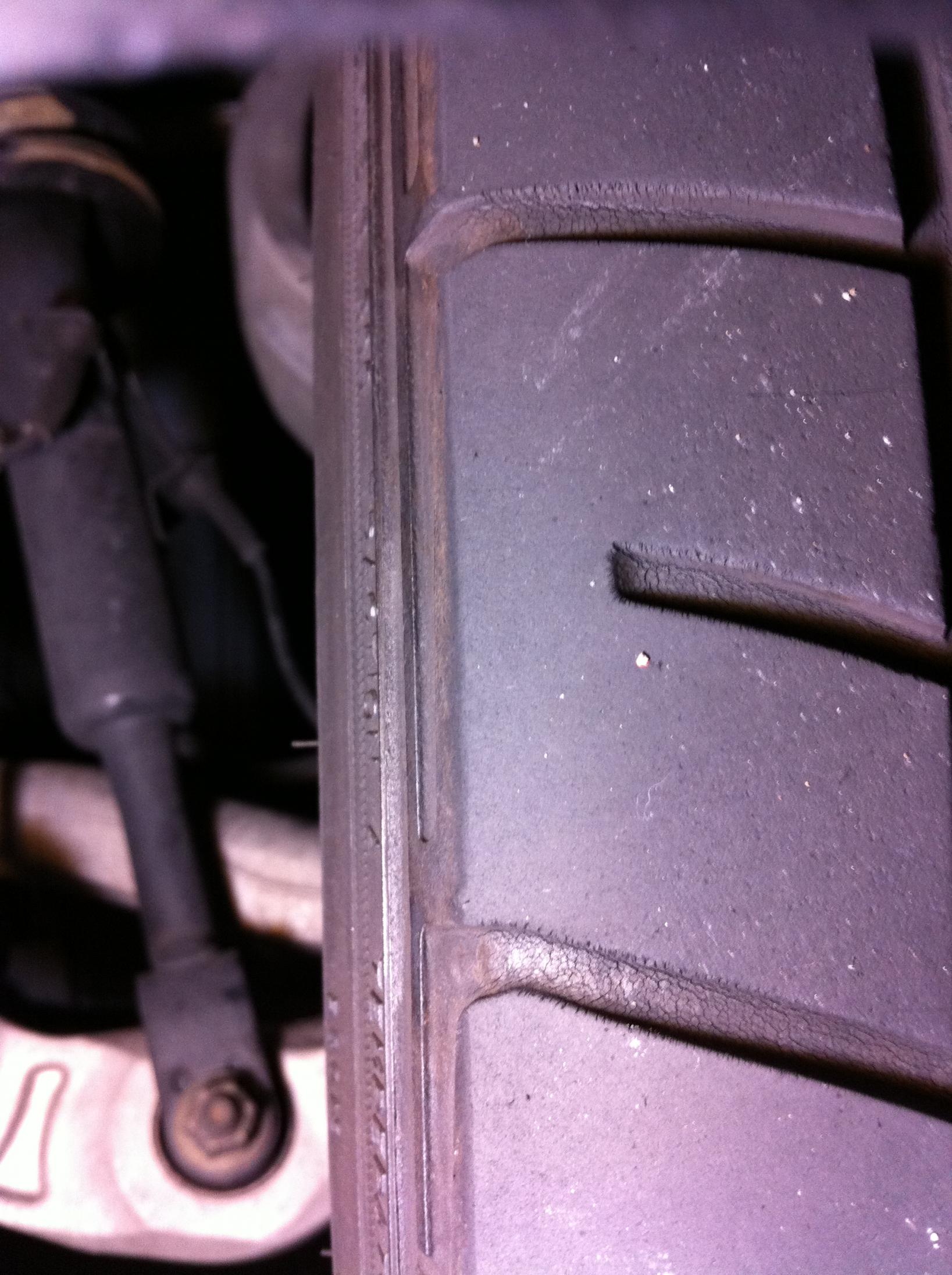

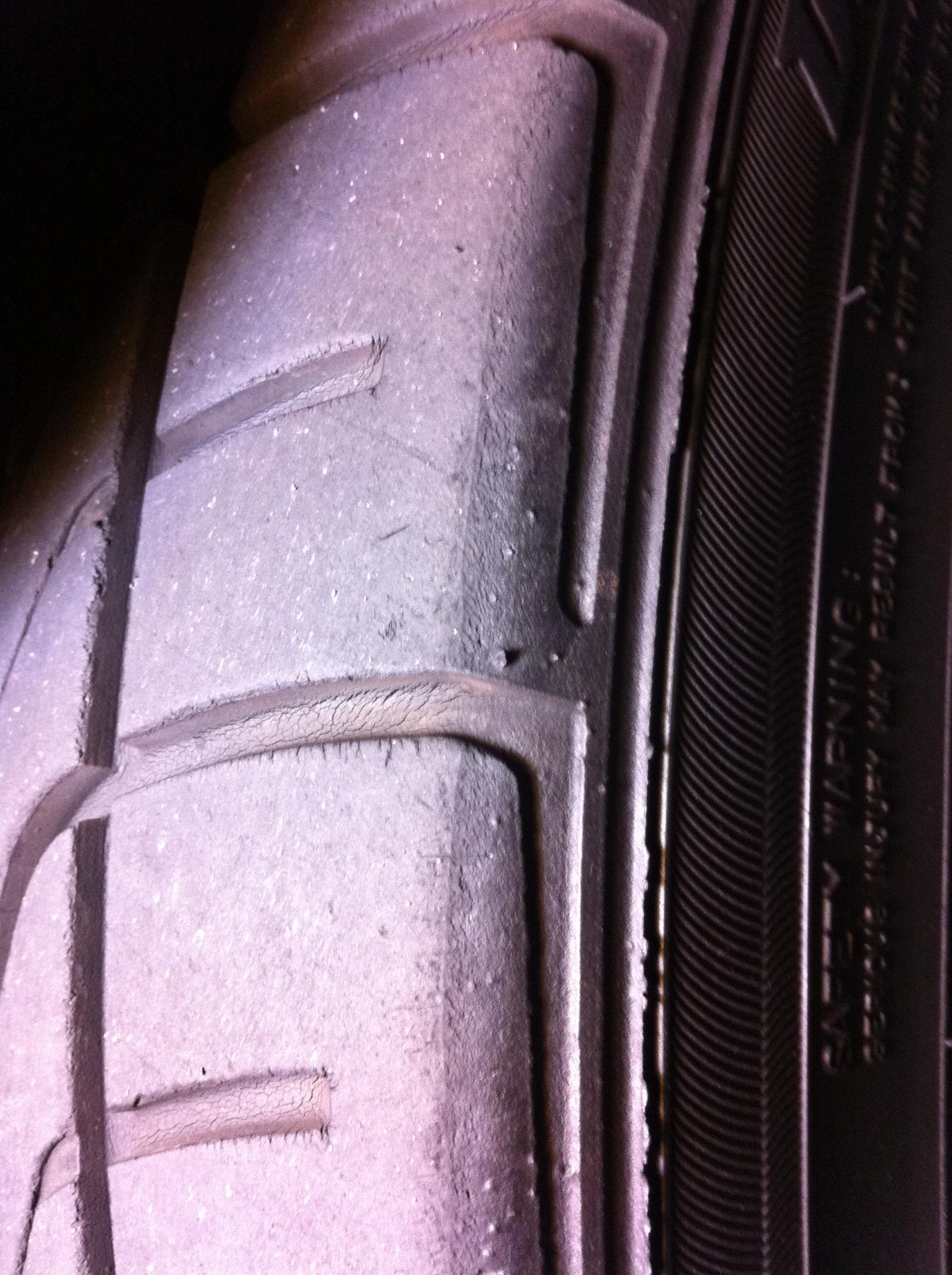

While i was under the car, i checked the tires to see how they are doing and looks like they are not doing so good..
Do you think that i should swap the front tires left and right? Not sure if spending $50 on swapping the tires is worth it for the amount of treads i have left. In the pic, the inner side doesn't show much of unevenness but if you zoom in, you'll see better. Does it look like normal wear with -1.0 and -1.3 camber?
IIRC, The tires had plenty of treads with even wear when i bought the car 39000 miles (dunlop durezza tires (dunno if these are from factory). i'm noticing this uneven wear pattern after 2000 miles and after getting the car aligned at big o tires after i bought the car (all four corners' toes were out of spec not the cambers). The car now has 41000 miles. Although i don't notice feathering spots but i'm leaning toward of having feathering issue with my 05 from seeing that the inner tires wear down so quickly.
Second pic is the inner side

As far as the tires, I personall wouldn't bother with them, they look fine to me.
