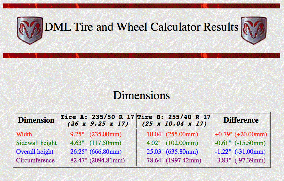

Thinking your rear tire size is wrong. The stock size is 235/50X17. According to the Miata.net tire size calculator, you your speed would read 57.2 when you are actually going 60 mph. That is pretty close to your figure. If this speedometer error concerns you, going to the correct size tires should resolve your problem. Your front size is also wrong.......they should be 225/50X17.
Correct.Name:  tires0330.gif
You altered OEM tire size. Actual speed 100.0 MPH. Speedometer will read 104.8 MPH.
