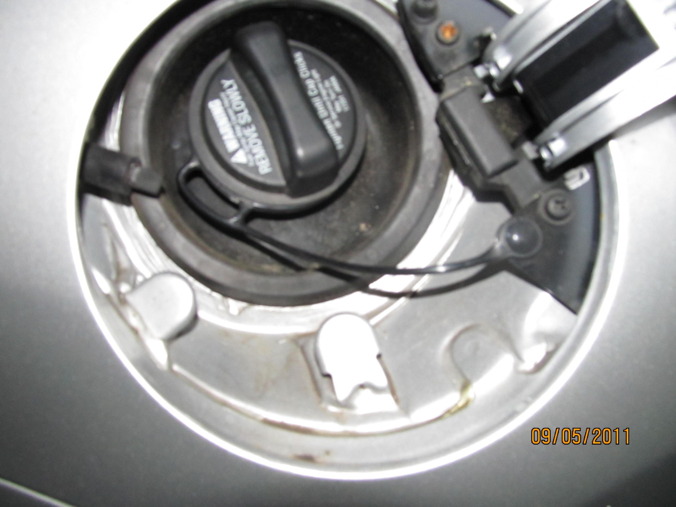

I just purchased my second 350z (I don't have 2, this is just the second time I've owned one) and I didn't notice any issues with it at the time of purchase but of course you're not going to identify all issues with a used car right away.
My concerns are with the passenger's side quarter panel, I think it may have been in an accident.
The first thing to tip me off is this weld mark behind the gas door...
... and between the passenger's side tail-light and the bumper I notice this seam that looked thicker than normal...
Any input would be greatly appreciated. Thanks

There are some weld spots in the gas cap area except yours has some rust. Very difficult to say if they are the original ones or not. Did you get a carfax or similar info?. I know they don't always tell all but sometimes they help

That is a interesting location for a defect. The paint inside the filler area looks original?
I agree. I wouldn't suspect anything more than maybe the car lived near the ocean/salt water due to the two rust areas that you pointed out.
Do you have a good paint match on parts from the door back after a good wash and wax?
Any gaps between parts that aren't spaced evenly along the seams?
Have you had an alignment done? Any issues getting everything in spec?
Those are the three things that I'd look at first. But I'm a noob, plenty of others on here with more knowledge & insight.

To be honest, I think it may have been in a minor accident. There was some paint fading underneath the hatch. From what I can see, it looks like whoever did the work did a pretty good job, other than the weld spot of course. It drives very well and is still pretty clean. I'm kind of a stickler about having things perfect, but I think I need to just appreciate the car and not freak out as much.

Here's what my car looks like inside the gas door. I'd say yours has had some work done on it.

Winchman, it does look like there's a small weld mark on yours, but I can't tell if there's a color difference around the rubber gasket on yours.

I took another look, and I'm sure there's no weld there. It just looks like sealant under the paint.
