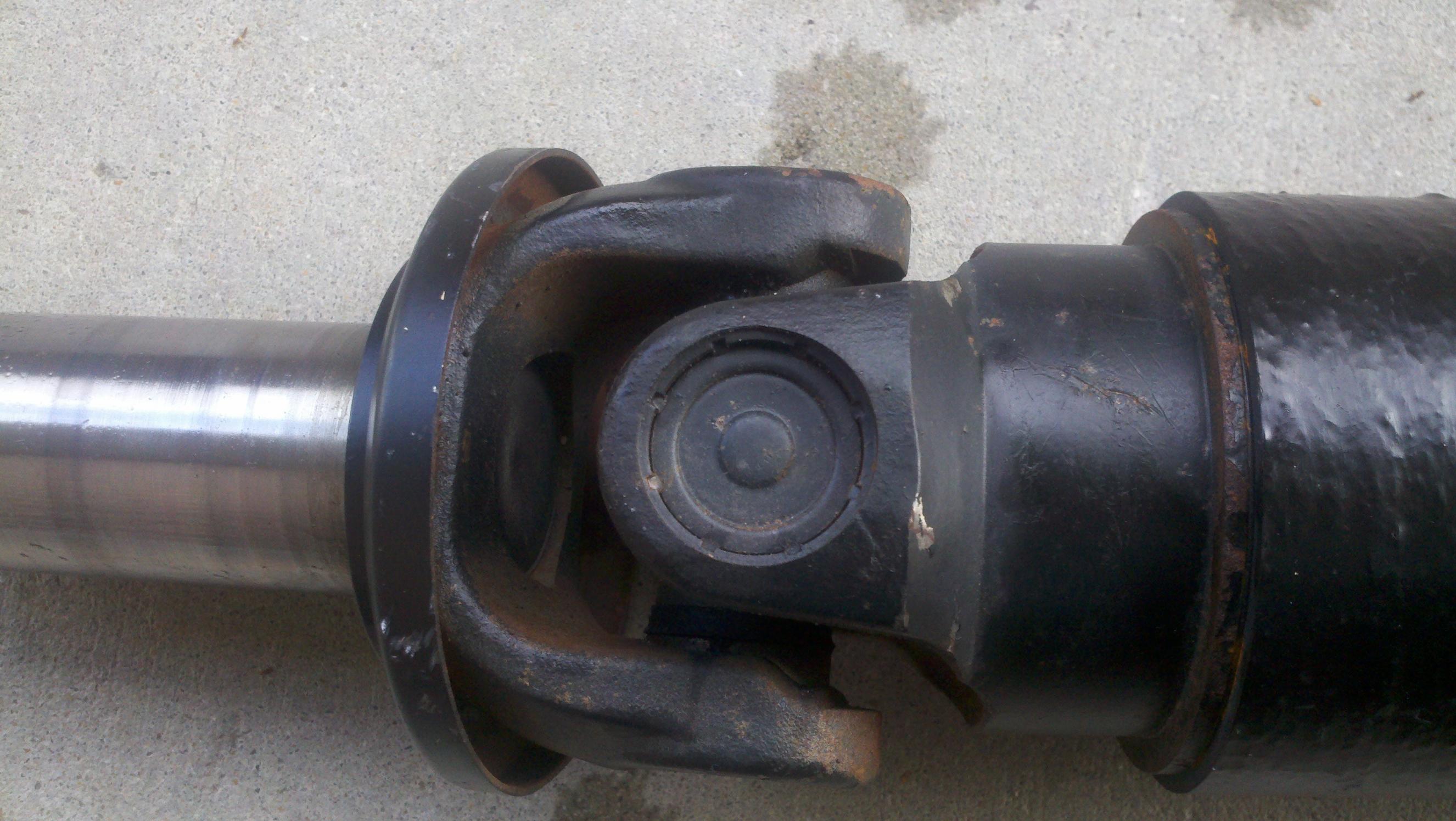

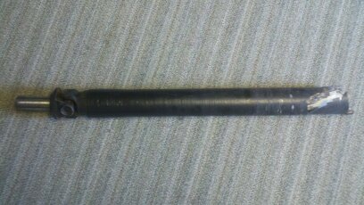

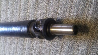

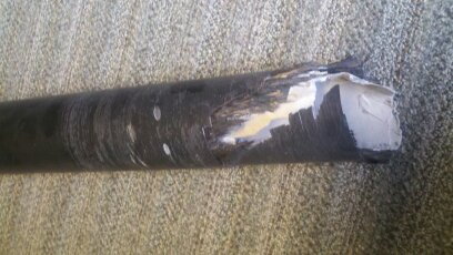

So I snapped my drive shaft at the track. First run down the track ran fine, second time snapped off the line. Anyways I ordered a new one, whats the best way about putting the new one back in.

How did it break and did you do a high rpm launch or whats up. Not sure on tips on how to put it back in..i guess how you took it out. Use a FSM that is available all over the web to help you out. Did you order OEM or aftermarket drive shaft and how do you go about making sure it does not happen again.

You're looking at the universal joint, that isn't what you have to remove. Just unbolt from the rear flange on the differential, and slide it out of the trans. Installation is reverse of removal.

How did you break the drive shaft with just minor bolt on's and launching at 3.5k? Crazy man sorry to hear that; but the install is easy. Slide the Yolk right in then tighten the 4 bolts on the rear to spec.
You buy an aftermarket one or an OEM one?
what year is the car and how many miles are on it?

The only thing I can thing of that might have played a roll in it would be the burnout. I had some minor wheel hopping, maybe one hop to much..?
