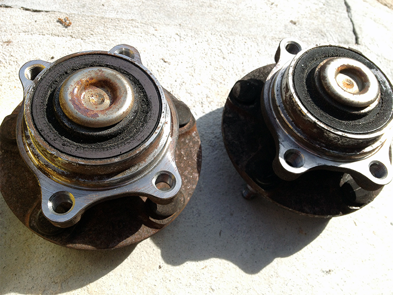

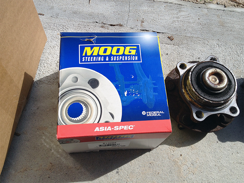

Hey guys, just reporting back. Got the bearing/hub assemblies this morning at around 9:30AM so we got straight to replacing them. Turns out it was the wheel bearings so I appreciate the help terrasmak!
Hope this helps other people
Old OEM rusty assemblies

New MOOG wheel bearing/hub assembly (part# 513268)

Originally Posted by Italianjoe1
You can feel roughness in them when turning them, but won't always notice play if they aren't too bad yet. They can be making a ton of noise and not "feel" bad as far as play is concerned, but they will be rough when you spin them by hand.
Easy way to check is put your hand on the suspension or knuckle and spin the tire with the corner in question jacked up, you should feel a vibration of sorts from the bearing if it's not smooth, transmitted through the suspension pieces. That's the humming noise you hear while driving due to the failing bearing.
OP, glad you got it sorted out, the bearings on these cars are very simple to change, and do tend to fail on a pretty regular basis.
Perfectly said man! My drivers side bearing was the bad one. So I removed the wheel and removed the bearing/hub. Turned it and it was pretty rough to turn. My passenger side bearing was smooth like butter but decided to replace them both

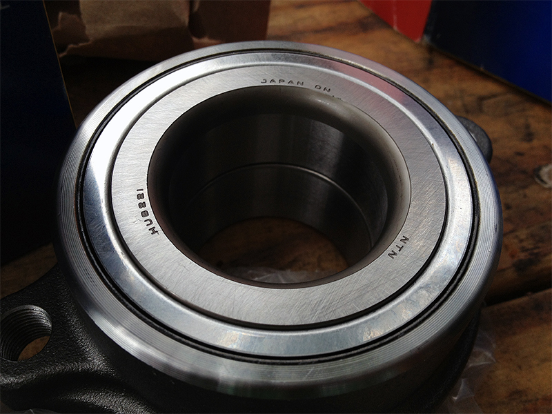

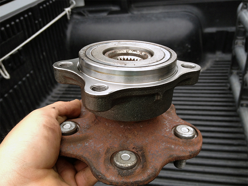

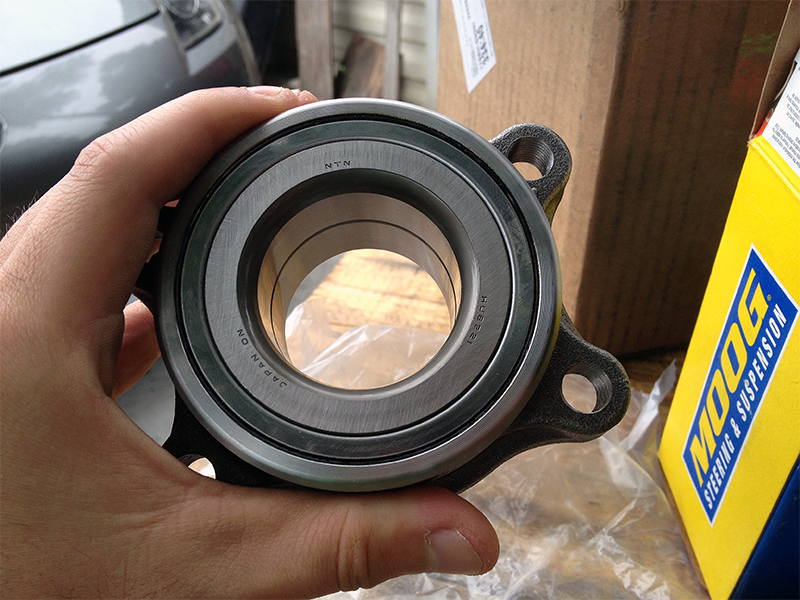

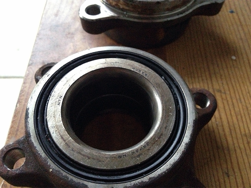

Hey guys,
Another update. I began noticing a quiet 'wumming' coming from the rear so I went ahead and ordered new bearings for both rear wheels. Stuck with MOOG since my fronts were great quality. Thing is, the rear bearings are actually repackaged NTN bearings (EXACTLY the same as OEM, pictures below to prove it).
Replaced them, took the car out for a drive, and the car rode smooth again and dead silent, literally.
If you guys notice a humming coming from the front or rear end of the car, big chances are it's your wheel bearings.
... and guys don't go to a dealer to replace these. Nissan quoted me 500$ (parts+labor) for EACH bearing they replace. Might as well
DIY or find a mechanic who can give you the hook up. I was charged 40$ to replace each bearing and that's the pressing work included.

Out with the old...

Bearing close-up. Notice the engraved text
Old OEM bearing close-up. Again, notice the engraved text (little blurry), but it's the same.

There's only a couple major bearing manufacturers, most of the aftermarket companies like Moog are buying bearings from the same places that make them for the OEMs.
