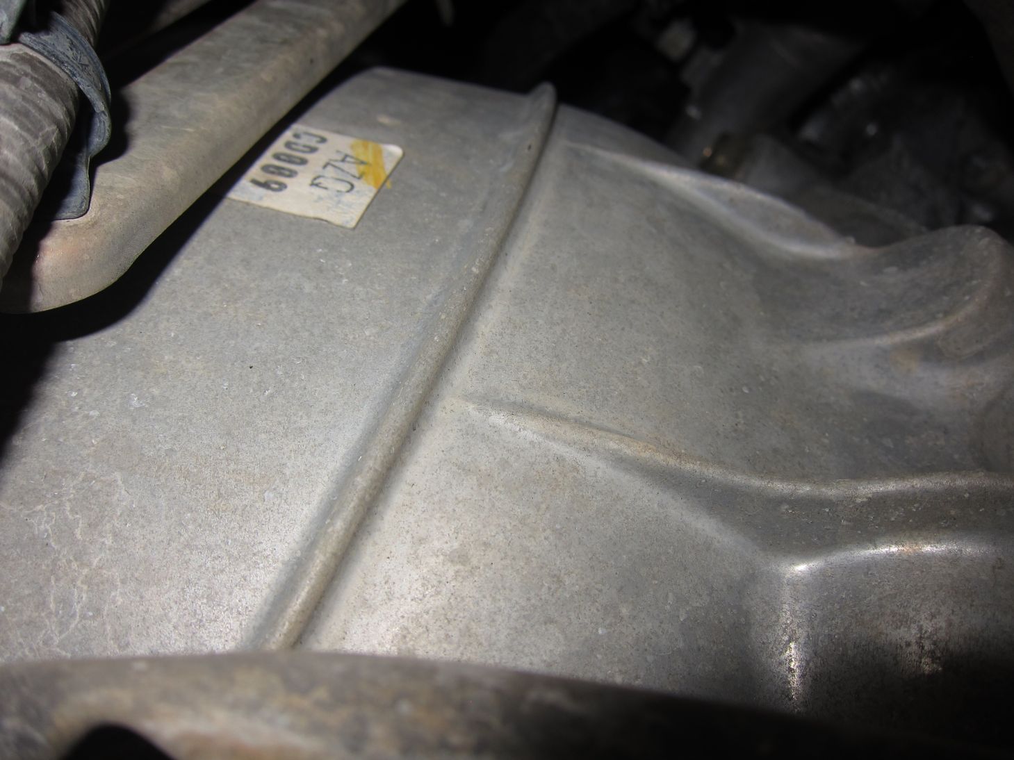

Highly doubt it is cd009 but with only 10k miles it should be in decent condition. A fresh fluid swap would help along with fresh diff fluid. Change out clutch fluid and then enjoy the vehicle and replace with cd009 when issues arise. During test drive you should drive like a dumb ***. Do your best to NOT REV MATCH and just shift extremely crappy and see if synchros will work like the are suppose to. Down shift without rev matching and see what happens. Pay attention to first, second, third and fifth as these then to have most issues. Get underneath on the passenger side and grab a digital camera. Take pictures up towards the center and top of the transmission. You will need to take like 5 pictures and you will get the sticker with revision number. Late 2004 is when 350z got the cd009 and early 2005 is when G35 got it. Your 2003 has a weak pivot bolt that is tall and you will want to go easy on banging the shifter around from gear to gear.

You are making it way too complicated. Just drive the damn vehicle and stick with the owners manual speeds for shift points. Here is a couple pictures of my transmission cd009 to get an idea of where the sticker is placed for revision.
