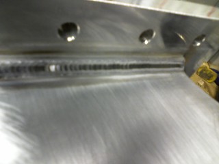

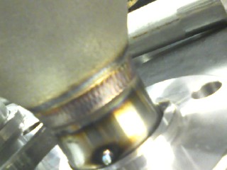

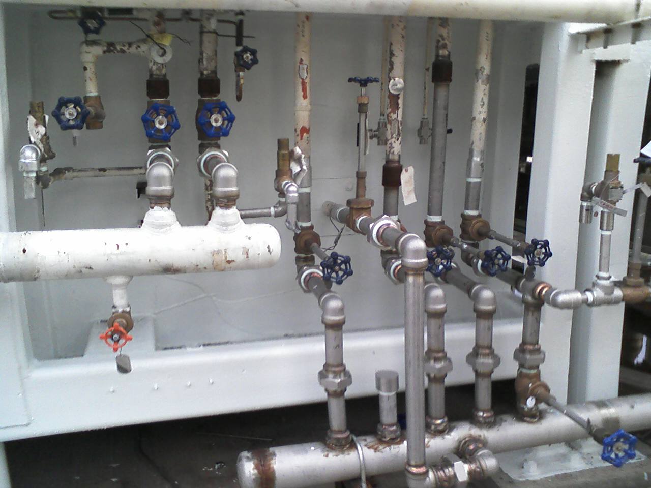

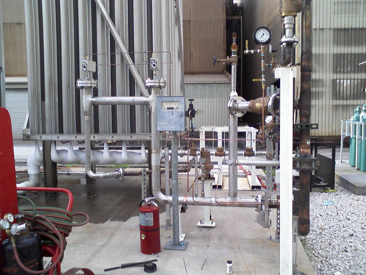

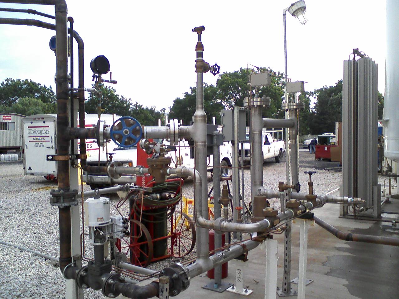

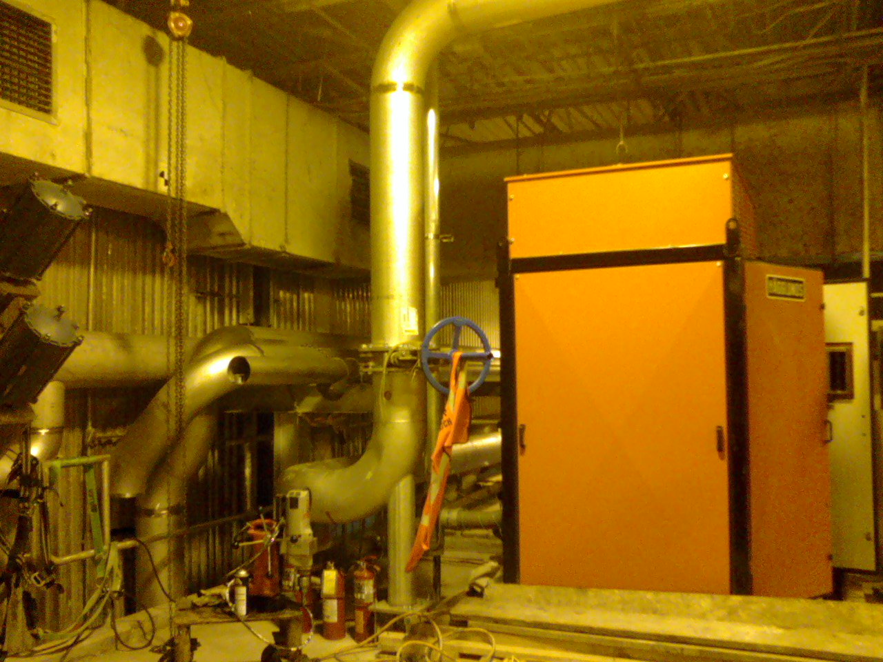

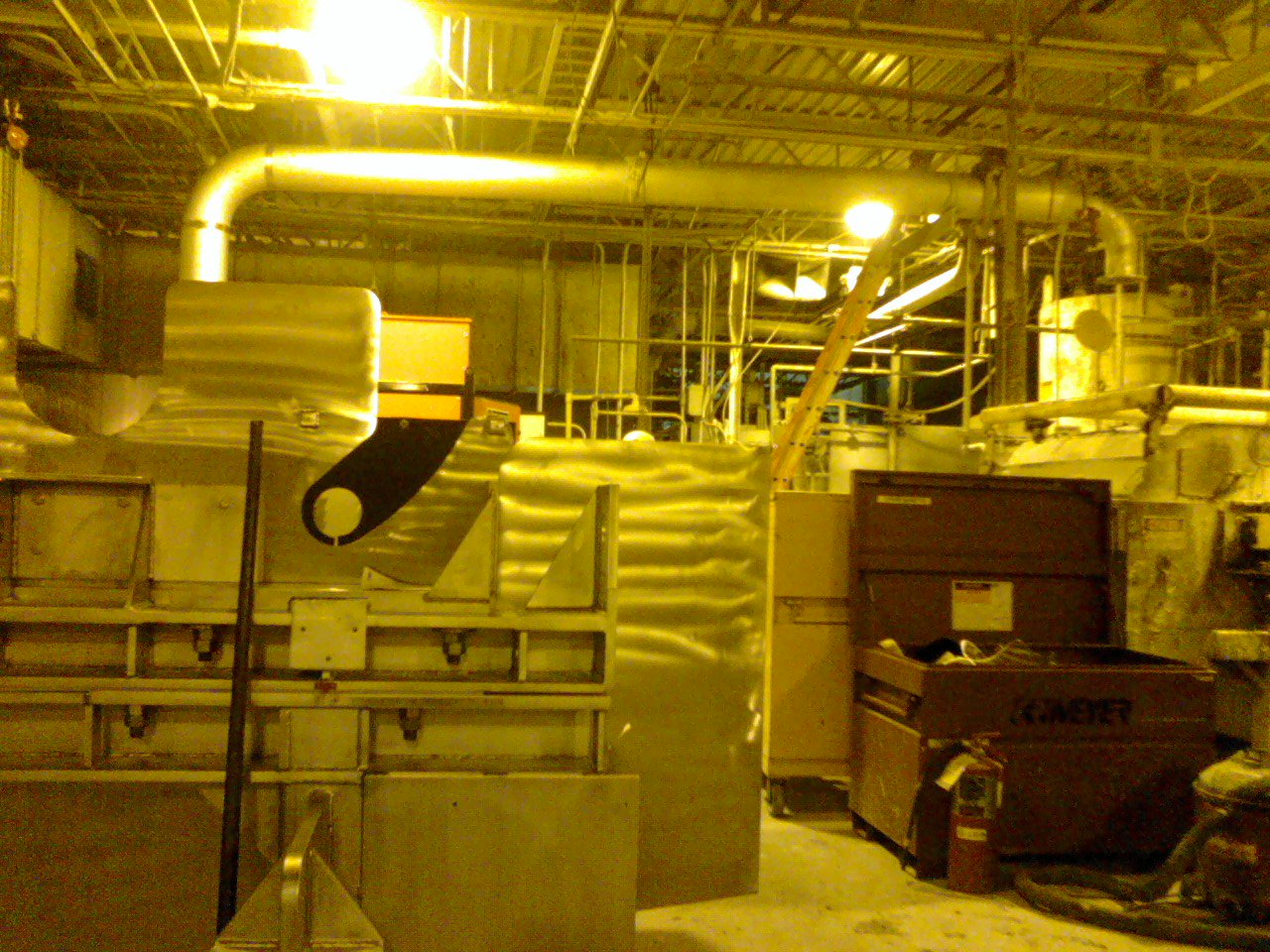

I've got quite a bit of TIG experience. I started back about 1987. I did find a few pictures of some of my work. Most of it's a few years old, at least.
In order:
1) DC aluminum TIG on a wave guide (microwave vacuum oven setup)
2) Stainless steel, 308, 2" pipe
3) Same as 2
4) This was some piping I put into a papermill, if I remember right, it was 8 and 10 inch.
5) Same as 4
6) A vacuum oven, about 3ft diameter, vacuum chamber type of stuff
7) This was a nitrogen station that I built at a steel mill.
8) This was also at the steel mill. I had to build new piping to tie into the existing equipment
9) Another of the back side of the nitrogen station
10) DC aluminum TIG

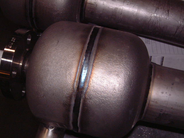

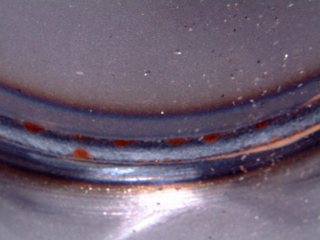

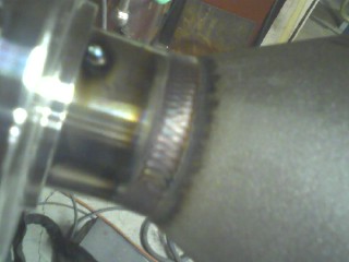

Here's a few more...
in order:
1) AC aluminum TIG
2) This was a cyclone that helped remove sand from saltwater. It was made of 254SMO material, welded with Hastelloy.
3) Copper-Nickel (95/5) TIG welded
4) Full penetration root pass inside a 6in carbon steel pipe, TIG welded.
5) Part of an X-pipe I made years ago
6) This bmp file, for some reason won't show as thumbnail. This is a 254SMO 2" socket weld fitting. I wasn't quite done with it when the picture was taken. I still put one more stringer around the top.
Attached Thumbnails If you need any welding tips or advice...-080709_1206-01-.jpg   If you need any welding tips or advice...-cyclone5.jpg.jpg   If you need any welding tips or advice...-dscf0012.jpg   If you need any welding tips or advice...-dscf0068.jpg   If you need any welding tips or advice...-dscf0292.jpg
