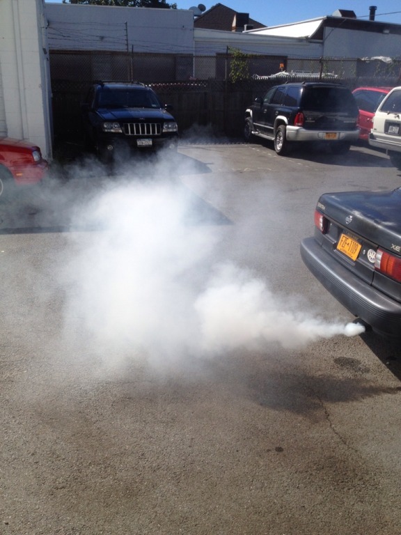

I am a huge fan of seafoam. It works great!
Just make sure if you use it you let it really sit in the engine for a few minutes few you crank it back up. With my personal experience with seafoam, after you start it back up, drive it and beat the hell out of the car. It will smoke like hell for a little bit but everything will get out.
Plus its tons of fun haha, at least to me. The amount of smoke is hilarious.
