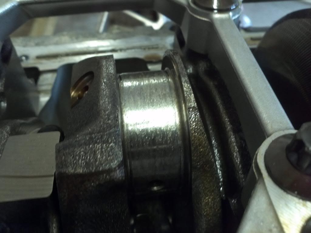

Originally Posted by Bruno350z
. I had a mechanic check it out, he said it was the rods on the bottom on the engine, fairly easy to access and replace.
Sorry i misread your original post. Your crank is probably hammered as well. I think it would almost cost more to have it machined and re-balanced. Here is what mine looked like after i spun a rod bearing. yeah and the pistons HAVE to come out of the top. so removing the heads is necessary. There are parts of the block that prevent them from coming out of the bottom. and i dont know if you can pull the rod off the piston head without pulling it all out.
At first he told me it can be accessed from the bottom, but after looking at pictures and researching how these engines are designed I realized I wouldn't be able to access it from the bottom and I would be pulling the engine. Which is why there is two posts that differ from each other. One could say I'm learning
And to me nothing looks wrong with that crank.... Could you please elaborate as to what's wrong with it?

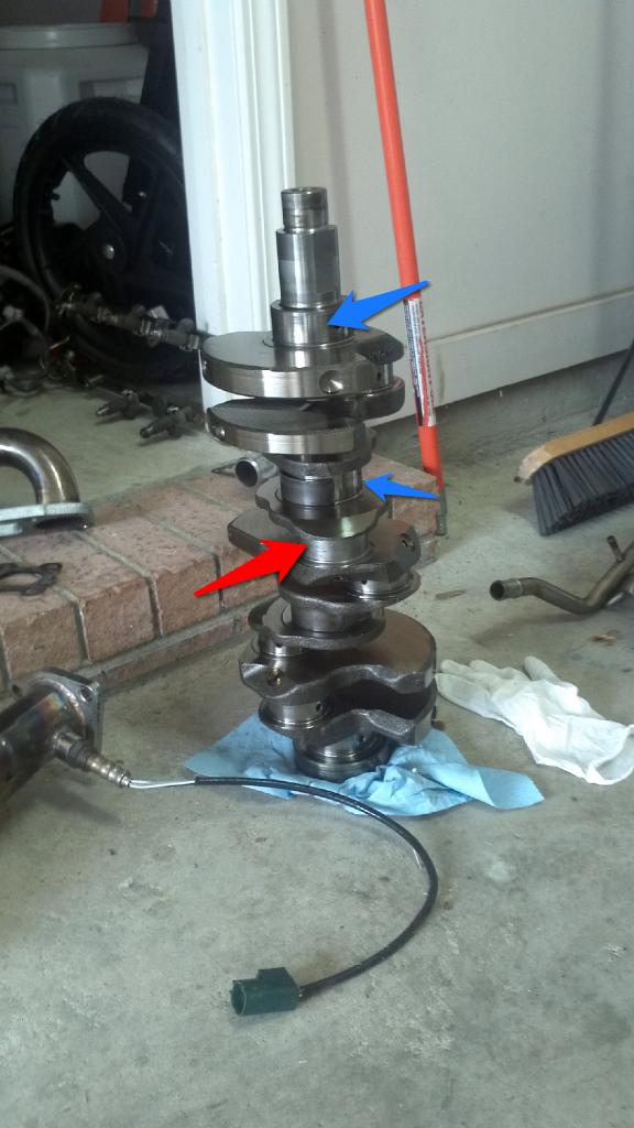

Thanks for the motivation
How can you go about flushing the metal out that went through the block? (If any at all did)
Any and all helpful tips are appreciated Also if you have a serious idea of what project to do with the car post em, I'll consider it. I mean it's just sitting there, I have nothing to lose lol
this is the best pic i could find. the journals should be very smooth. The blue arrows are the undamaged journals, the red marks the one with the spun bearing. If you were to machine the journals, you would have to get someone who knows exactly what they are doing because you will need to measure for larger bearings as well and these things need to be measured to like the thousands of an inch.

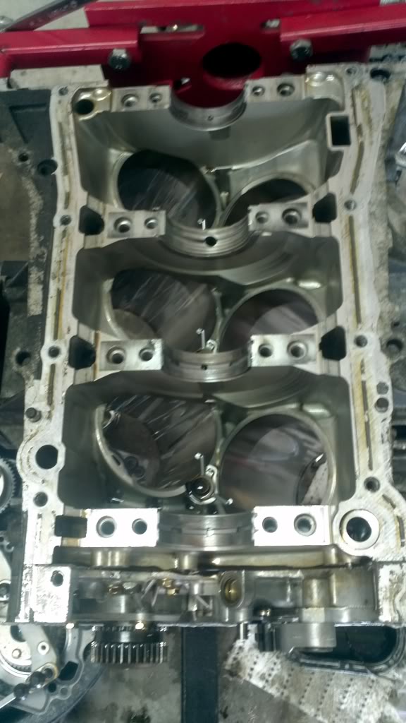

as for the metal in the engine, this is what my engine looked like for the rebuild.... Plenty of places to clean. hah.
and once you get the block apart, you can clean it as well. just remember to flush and blow out the oil galleries and might as well do the coolant passages as well. this is what it looks like.

all that being said, if you chose to do this yourself for the first time. It WILL BE very time consuming and you will probably make a few mistakes along the way. Just pray you find them before starting it up for the first time. I cant tell you how many times i had to pull the front timing cover off after i got the engine back in the car to do something i forgot.

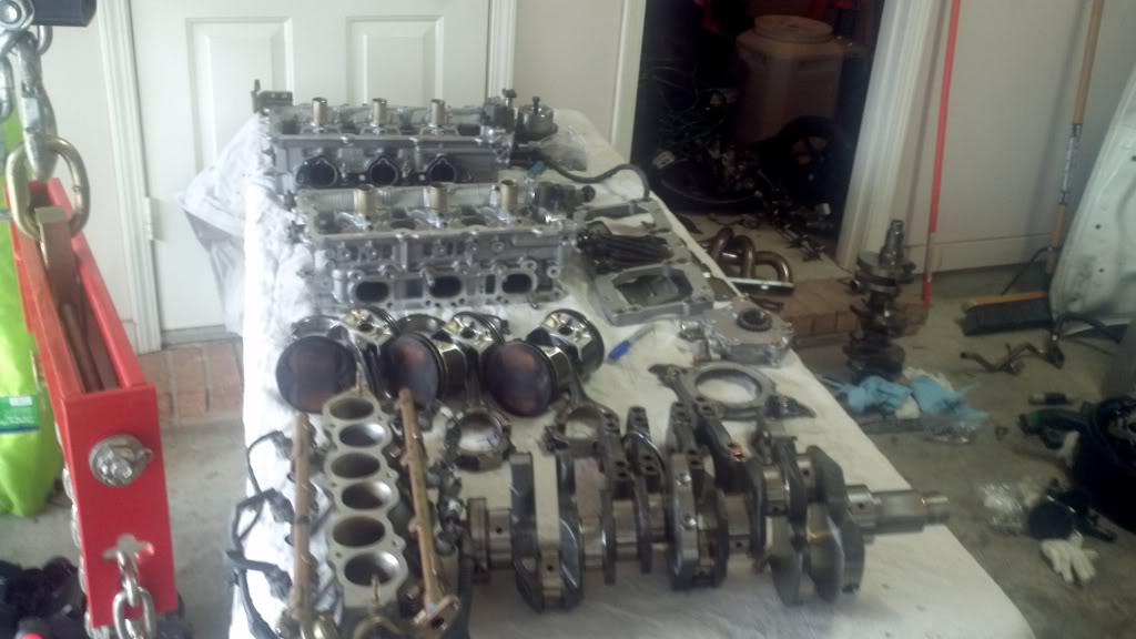

Old May 18, 2013 | 02:00 PM
  #79
Bruno350z's Avatar
Bruno350z
Joined: Jul 2012
Posts: 440
From: Rosemead
Hey guys, my progress so far. First day I didnt do much on removing it, just removed plenum, alternator and belts before I ran out of time. Today was my next day off to work on it, got a lot more out. All I need to remove now is the wiring harness, a few more hoses, driveshaft, unmount and the engine is ready to be pulled out.
However, for the removal of the wiring harness.. I'm stuck here. How does this part get removed? I only took a quick look at it, then moved on to remove everything else before getting stuck on one object.
Are there clips on the bottom? Or how exactly is this piece removed to disconnect the harness
