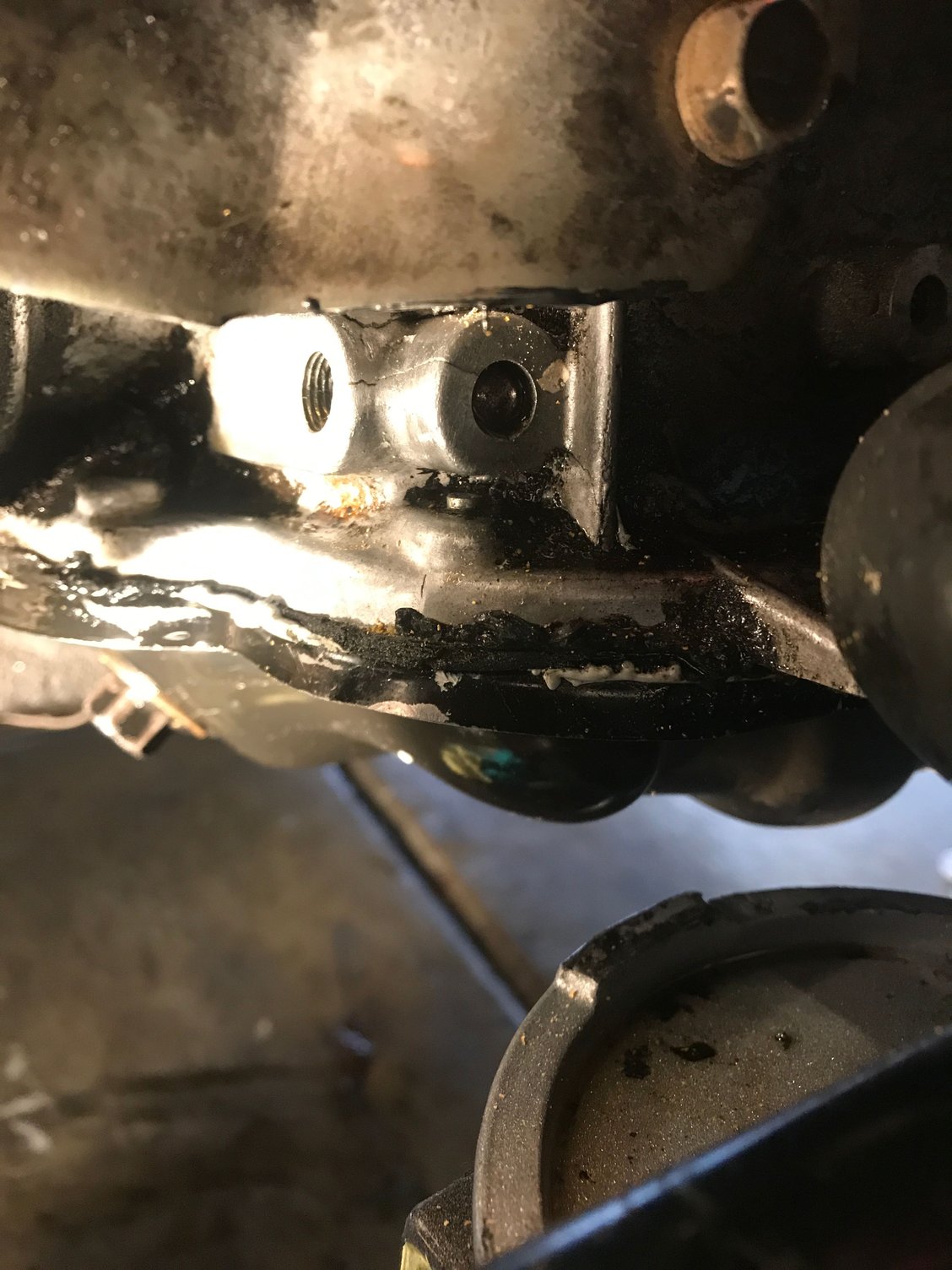

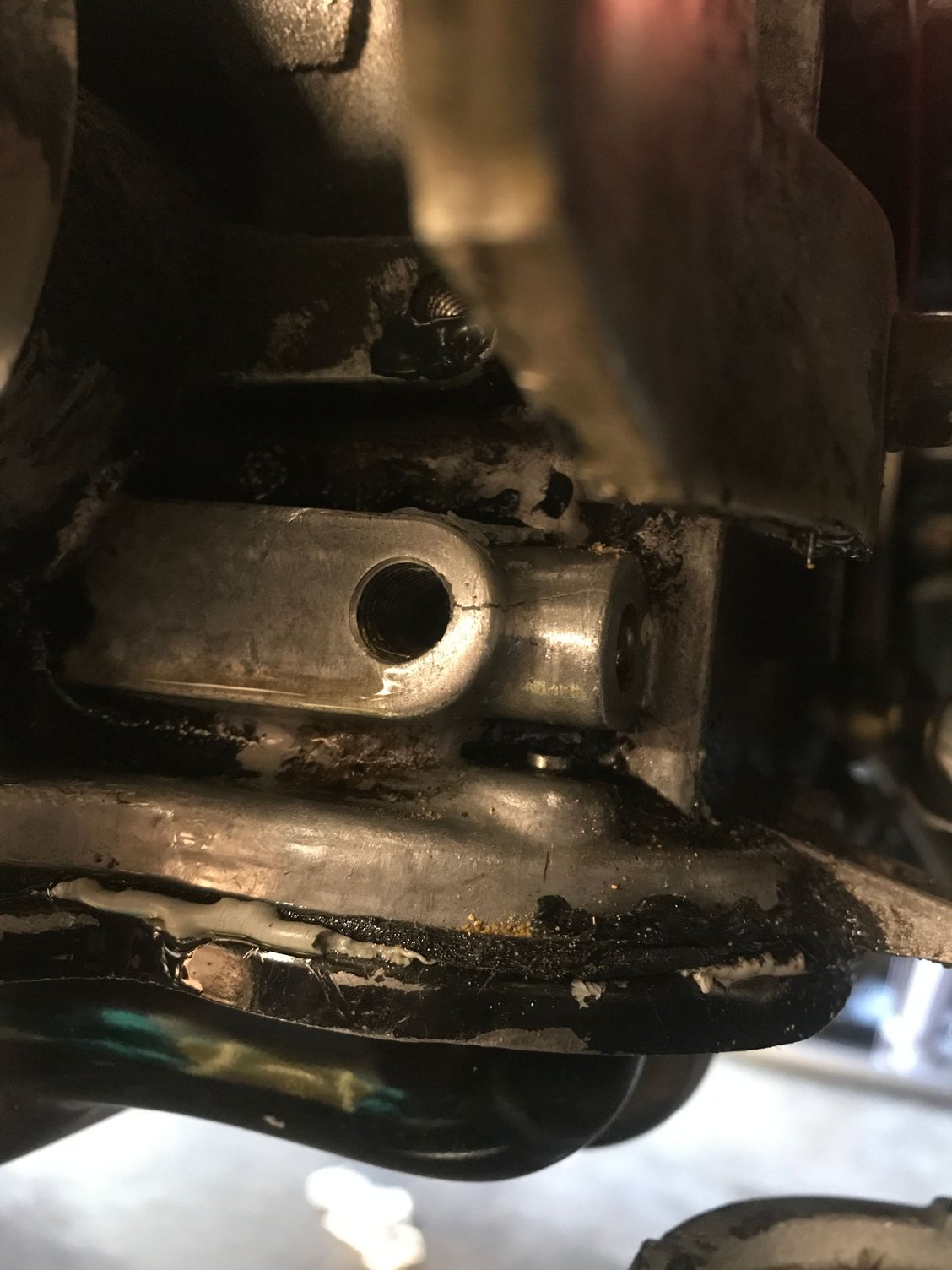

Default Oil pressure sensor housing cracked
I have the same problem not as bad. I didn’t tork the sensor down that hard but being as the the oil pan is made of aluminum that’s why this is a common problem. If I was in his boat I would just replace the upper oil pan sucks ba*** but you don’t want anything to happen while your on the road. I have a question as well? Should I get this welded or? Replace the upper oil pan?

man again. You’ve replied on more than one thing the same thing over and over again. You CAN NOT weld a casting. JB weld won’t work either. There is 90PSI going through there. Pay the money and replace the upper pan or do it yourself but I wish you luck if you do

You 'could' weld that - I wouldnt recommend it and it'd have to come off the car. I've welded a few things onto OEM cast aluminum but like any welding you must clean and prep it after you clean and prep it before you clean and prep it.
Welding onto any used OEM cast aluminum pulls the contaminates out and makes it difficult to run a good bead.
OP - I have a few extra upper oil pans and I'd be more than happy to sell a replacement at far below new or used prices - shoot me a PM and we can chat about it.
