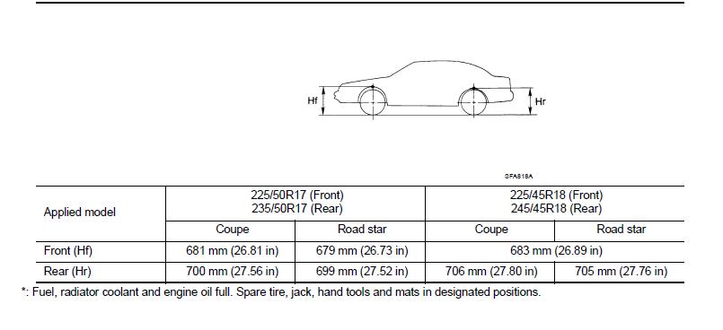

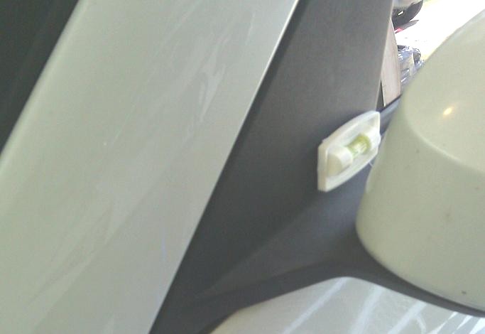

start by measuring your car to begin with:
Originally Posted by JasonZ-YA
Prior to making any changes:
1. I note down where exactly I park in my garage - which is relatively flat. (use chalk on the ground, blue tape, etc)
2. I then push down on the hood, hatch area and ensure the suspension is settled.
3. I measure the fenders like show in the FSM pic below.
4. I check to ensure the car is level and remember where the bubble level is sitting.
I mount a RV temporary bubble level on my car and ensure I have it all covered!
-J
