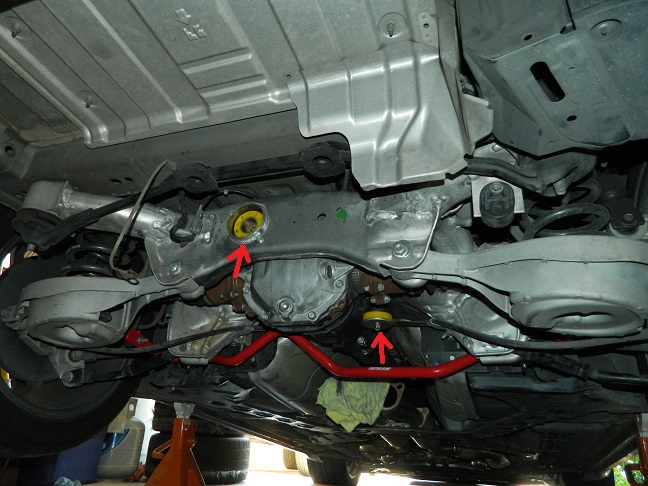

nissan will tell you that, because the bushings are pressed in, but you dont have to replace the whole subframe. i recently did mine and it is a PITA, you have to drop the rear end and the rear subframe some. getting the factory bushing out took the longest. me and a buddy knocked it out in under 5 hours and that is BSing half the time, along with beer breaks

i replaced mine with the whiteline poly bushings
Attached Thumbnails Rear Diff Bushing leaking/ blown (2008 350z)-img_20130622_115426_444.jpg   Rear Diff Bushing leaking/ blown (2008 350z)-img_20130622_131045_472.jpg   Rear Diff Bushing leaking/ blown (2008 350z)-diffbushingbefore_zps937c9c79.jpg   Rear Diff Bushing leaking/ blown (2008 350z)-diffbushingafter_zpsa71e5e2f.jpg

you have to drop the rear end out completely so you might as well change them all. you will get a little more road noise but a little better response also. i bought the whiteline bushings from Concept Z
