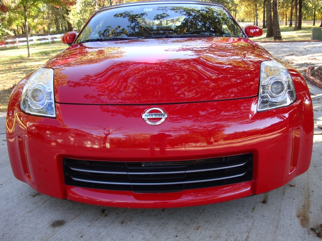

These pics were taken about 6 feet back on the full bumper and about 3 feet back on the hood. Good results from this distance.

These two corner shots are close enough that you can see the many paint imperfections. Many are rock chips that did not remove paint but dented where they hit. If you are standing up 5 or 6 feet away it is not noticeable. Again, perfection can only be achieved if the bumper and hood are taken off and properly fixed and painted at a good body shop.
Perhaps I should have used a clay bar before starting the process in order to pull imperfections out of the paint. Don't know. I have never used a clay bar so I don't know.
I bought the 3m scratch removal system from Amazon. Also purchased 1 extra bottle of the scratch removal polish and the fine rubbing compound liquid. The kit just does not have enough of either.
I went too fast on my repair. Worked too big of sections with Dr. PaintChip. If you do this take your time on smaller sections. Use the squeegee. Sometimes after drying and Sealtacing, you might do it again to add more layer of paint to the chip. Just do not get in a hurry.
