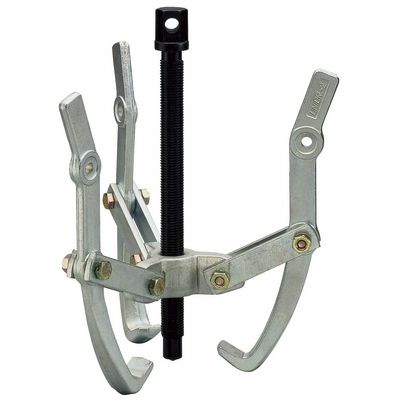

Just buy one of these. Makes life a lot easier.

That puller is not what he's talking about. BJR is referring to the hub assembly being corroded into the knuckle, after you knock the axle out you may have to quite forcefully beat out the hub. Being that OP is in Miami, if the car isn't a previous northern car, one good whack with a hammer is usually all it takes.
I had to get behind a hub bearing and beat it out with a hammer and chisel to show one of the other techs at work how to do it last week. He was trying to take an air hammer to the seam on the side. It took quite a bit of persuasion to knock it free but it came out eventually. Be sure to CLEAN the inside surface and all mating surfaces well and apply a layer of grease/anti-sieze so everything goes together nice and true.
