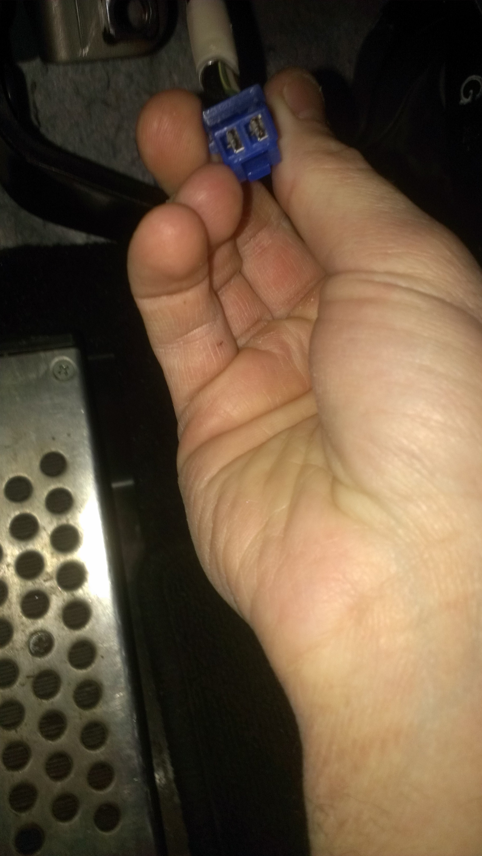

Ok so I finally got that damn connector loose and removed the switch altogether. (Thank you fmx10!!)
Now I'm left with the wire.. (attached pic)
I'm guessing I put the jumper wire from the left hole, into the right hole and that will bypass the clutch interlock switch?

That seems to be what the other guy said, what's the worst that could happen lol. I hope it works

If it's only 2 wires then you can simply jump the 2 together.

So I used the jumper wire and wouldn't you know she turned on!
Now time to goto Nissan and see how much a new switch is gonna cost. Thanks so much to everyone that helped out! I feel whole again
