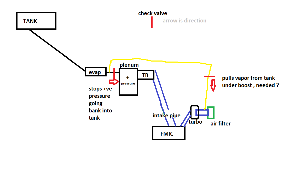

I made a diagram based on help given so want some feedback if it will work and if the yellow line is needed. i guess only for those on boost alot with no break like track.
Ok i tested the EVAP solenoid and i could blow through both ports and suck also. so its letting air straight through from the plenum into the gas tank.... even after leaving engine running for 100seconds which is when it starts pulsing it did not make a difference.. But could that cause boost leak / Leaning out issues or just the pressurized tank ?
It would pressurize the tank. Some evap solenoids do go back and won't hold boost. I know some ppl on here say that you have to have that check valve in place like in your diagram but I pressure tested my evap solenoid and it held 50psi without leaking so it's definitely not a design flaw, it's just a part failure. Putting a check valve between the evap and the plenum so it stops boost from going into the evap system should fix the issue instead of having to replace the solenoid. Don't hook up any other crazy systems like you put in there to draw out of the tank. During boost times you won't build up any significant pressure in the tank so when you let off the throttle and the plenum returns to vacuum it will pull the pressure off the tank like it was designed.
So that will fix your issue on that front. Did you check injector duty cycle? The fuel pressure and injector size you are running would easily max out at those power levels and cause it to go lean. I'm running 20psi higher base pressure than you just to get enough fuel through the 1000cc injectors on e85.
