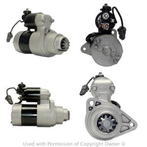

The one I got is similar to this one that you posted earlier, the connector, the nose and even the mount hole.
It's a Denso 280-3133, from which every auto part sites say exact fit. Or am I being tricked
Only thing I can't figure out is the connectors are opposite and can't fit. Is there one you recommend?

Looks like you pulled the whole connector out. You should be able to take the male end out, it is the side pointing away from the camera.
I change my starter with one from Autozone and the tab on male plug that came with it broke off as soon as I connected it. It is stuck in there so I put electrical tape on it to make sure it stays.

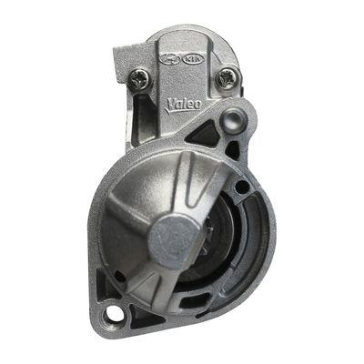

The one I pictured was for my 04. I just got on autozone and looked up an 08 350z and got this.
They changed design on the HR engine.
Old Sep 25, 2014 | 02:40 PM

Yea on second look the mounting holes look like they don't line up
