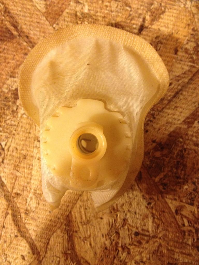

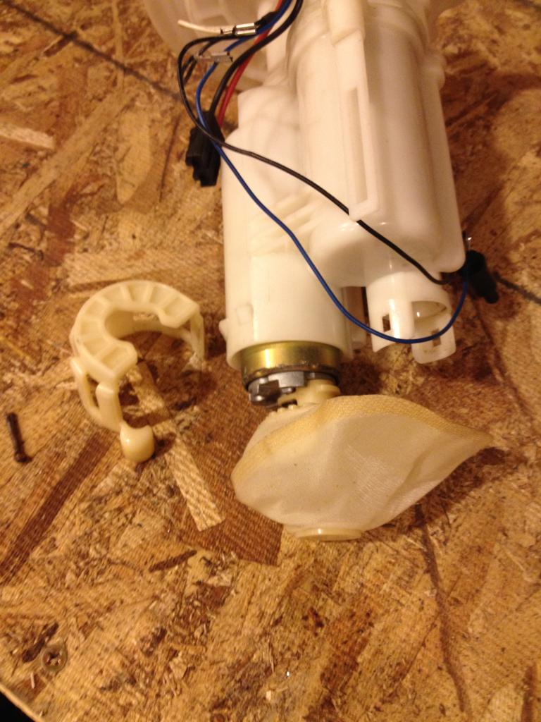

Just the sock...

no inlines...

Okay just one sock on the pump just as mine has. Although when I took mine apart it was pretty dirty. Funny how Nissan seems to think that this one sock will keep all debre out. After cleaning my non serviceable(********) sock debre continued getting into the injectors shorty after. Problem is if there's a tear i didn't see nobody sells just the sock which puts me back at square one with out modifying the line.
