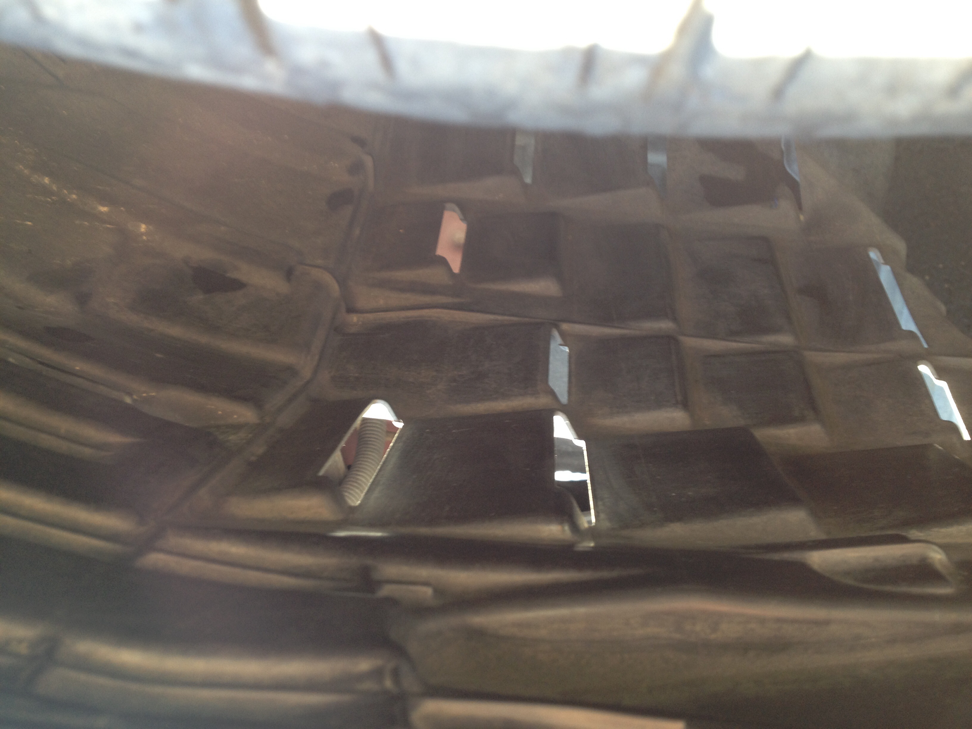

Update: so I took the ballast off and boy when I blew on the opening connection did water splash out. I disconnected and tilted upside down and quite a few drops of water seeped out. Now I gotta let it dry! Could I speed it up with maybe a blow dryer? Sun will only be out for maybe 5hrs or less. Leaving it on my dash since it's pretty hot outside right now.
I have a fender liner but I can see why it's a problem because there are slit openings everywhere -attached photo- are there liners with no openings? Guess I can google that myself lol

travlee's Avatar
travlee
Master
Joined: Jul 2011
Posts: 49,725
Likes: 9,296
if you have any of those silica gel packets, put it in a zip lock back with those, they will pull all the moisture out
